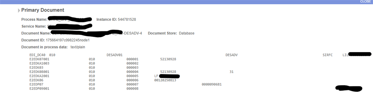

  • 4.  RE: Issue Posting Inbound DESADV IDoc via JCo Adapter - Segment Table Empty Error
    Posted 06/30/25 09:18 AM
    Hi Vamsi,
    I mean the process code which handles the idocs once created.
    This is how an DESADV idocs looks when sending it to a SAP system from our SI:
    Perhaps that helps?
    Are you using the same BP for all idocs to be sent? Or is it a separate one for DESADV?
    Best regards
    Manuel

  • 5.  RE: Issue Posting Inbound DESADV IDoc via JCo Adapter - Segment Table Empty Error
    Posted 06/30/25 09:52 AM
    Edited by Vamsi Kamisetty 06/30/25 11:24 AM
      |   view attached
    Hello Manuel,
    Am attaching the idoc I am trying to push into SAP. We are using the same BP that process ORDERS idocs into SAP which works fine. Not sure why the DESADV or SHPCON won't work. Our current application GENTRAN loads the same idoc generated out of SI without any issues. I compared the idoc side by side between GENTRAN and SI and they are identical. That's where the confusion is. We are using the same JCo for inbound and outbound documents.

  • 6.  RE: Issue Posting Inbound DESADV IDoc via JCo Adapter - Segment Table Empty Error
    Posted 07/01/25 12:56 AM
    Hi Vamsi,
    we always populate the client also in the each segment.
    Further the segment number in EDL22 seems off.

  • 7.  RE: Issue Posting Inbound DESADV IDoc via JCo Adapter - Segment Table Empty Error
    Posted 07/01/25 10:21 AM
    Hello Manuel , Thank you for the detailed information. I tried inputting the client record 010 on every segment and no luck. I am also attaching the ORDERS IDOC which is working fine and it doesn't have client record on every segment. I am attaching the DESADV idoc that isn't working even after updating the client record along with the error shown in the BP.

  • 8.  RE: Issue Posting Inbound DESADV IDoc via JCo Adapter - Segment Table Empty Error
    Posted 07/01/25 07:19 AM
    Hi Vamsi,
    I have seen this before.  It looks like you have an IDOC number in the control record, 010.  This needs to be on each of the segments as well. You can see that on Manuel's example.
    The function module in SAP inputs the control record and the segments in separate tables. It then tries to match them up based on the IDOC number. It also works if you leave the IDOC number off the control record and segments and you are only passing 1 IDOC at a time.  Either way it needs to match.

  • 10.  RE: Issue Posting Inbound DESADV IDoc via JCo Adapter - Segment Table Empty Error
    Best Answer
    Posted 07/01/25 10:31 AM
    Hi Vamski,
    please try to delete the 16 zeros in the field DOCNUM.
    As you don't have the DOCNUM in the DC40 segment, you should not fill it in the segments. Or use the same number in all of them (which has to be used when you are sending more than one idoc in the same document).

  • 12.  RE: Issue Posting Inbound DESADV IDoc via JCo Adapter - Segment Table Empty Error
    Posted 07/07/25 04:42 PM
    @Manuel Frank, it was the DOCNUM that was causing issues all along and nothing else. I changed the DOCNUM field to empty spaces and it worked like a charm on both DESADV and SHPCON idocs. Thank you again for all the help. Much appreciate it.
    @John Morrissey Thank you for all the help and the suggestions. The zeroes in the DOCNUM was causing issues. Not sure how it worked with GENTRAN though but doesn't work with SI.
