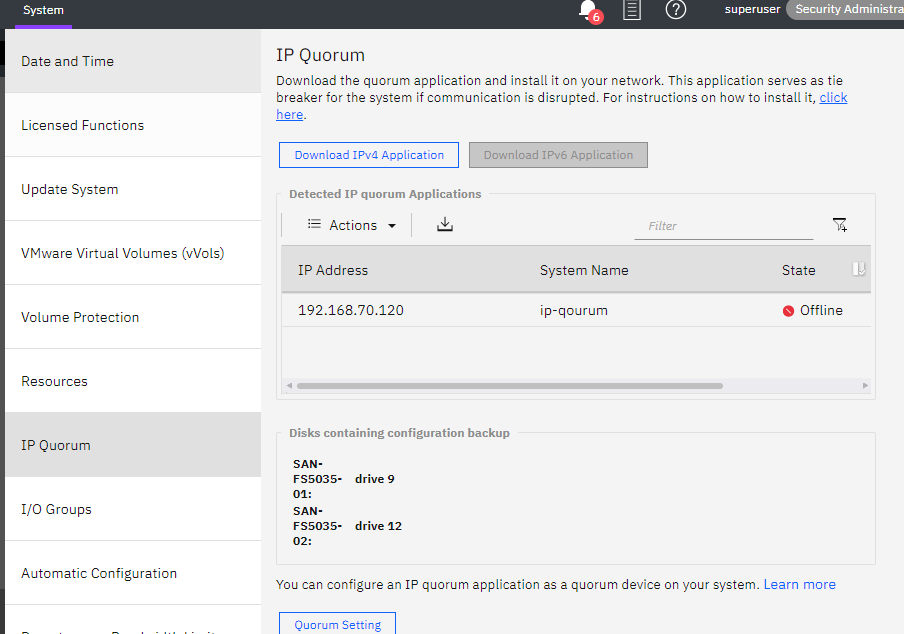

    Hi everyone!
    i download and run ip_quorum.jar on CentOS Stream 8
    [root@ip-qourum ~]# cat /etc/os-release
    NAME="CentOS Stream"
    VERSION="8"
    ID="centos"
    ID_LIKE="rhel fedora"
    VERSION_ID="8"
    PLATFORM_ID="platform:el8"
    PRETTY_NAME="CentOS Stream 8"
    ANSI_COLOR="0;31"
    CPE_NAME="cpe:/o:centos:centos:8"
    HOME_URL="https://centos.org/"
    BUG_REPORT_URL="https://bugzilla.redhat.com/"
    REDHAT_SUPPORT_PRODUCT="Red Hat Enterprise Linux 8"
    REDHAT_SUPPORT_PRODUCT_VERSION="CentOS Stream"
    and Java version
    [root@ip-qourum ~]# java -version
    openjdk version "1.8.0_362"
    OpenJDK Runtime Environment (build 1.8.0_362-b08)
    OpenJDK 64-Bit Server VM (build 25.362-b08, mixed mode)
    and when i run ip_quorum.jar in centos, i have a error like image bellow
    and state IP Quorum is offline
    I have attached the log file
    Hope everyone can help me solve this problem
    Thank you very much!!!

    Hi,
    As you can see in the log, the ip quorum accesses only 3 nodes. There should be 4

    Thank you for your replay, but I don't understand why it only recognizes 3 IPs, My server pings all 4 IPs and gets a response.

    Hola Cuong!
    • Is the status of your 4 nodes OK?  Are you able to ssh and authenticate to all 4 nodes or only 3? Specially to the the one with IP address .121
    • Is it possible you have a duplicate IP address 192.168.70.121? You could try removing the ethernet cable and ping to the IP address
    • is the output of sainfo lsservicenodes OK?
    • Don't you see issues against eth ports if you issue lseventlog -message no
    • Don't you see any additional clue in the log file generated in /opt ? There should be a log file called ip_quorum.log.<timestamp>
    • Have you tried rebooting the node with 192.168.70.121 in the case it has a funny condition?

    Hola Cuong,
    Have you check all prerequisites in the IBM page?
    https://www.ibm.com/support/pages/node/7013877
    https://www.ibm.com/support/pages/node/7001603
    I have a host with RHEL8.8, the code in my Flashsystem is 8.7.0.0 and works with no problem. Which code has your Flashsystem?

    Another possibility could be the linux firewall I guess...  I have it off due to it's a test environment
    Note. I don't see the IP quorum log file attached.

    I using Centos 8 Stream and openjdk version "1.8.0_362"
