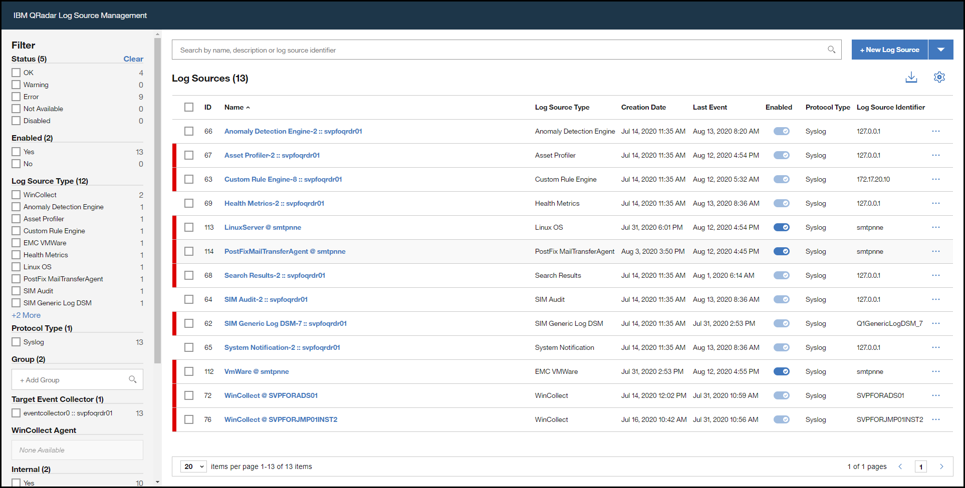

    I'm learning about QRadar and at this point I decided to install a DLC to learn about that possibility. The problem is: I can not find in QRadar 7.4.0 where I add that type of element. All documentation I find shows:
    "In the QRadar Log Source Management app, click the navigation menu icon (3 horizontal bars), and then click
    Disconnected Log Collectors > Register Disconnected Log Collector."
    Mine doesn't have this option. I have downloaded and running as TRIAL just to learn.
    Any clues about what I'm missing? Should I install anything before adding DLC to QRadar?
