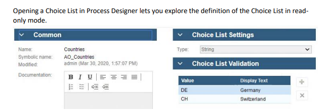

  • 7.  RE: How to use ChoiceList coming from Case Manager in BPM
    Posted Tue October 13, 2020 07:46 PM
    Hi Paul,
    I read the document you shared. I don't think it has the answers Marco is looking for. He's looking for 2 solutions:
    - Display Choice List on a coach
    - Edit Choice List from a coach
    In the article, it first explains that you can now see Choice List in BPM's Data.
    It then explains how you can explore Choice List from Web PD
    Then it ends there. It doesn't explain how you can actually use it in a BPM process execution context i.e. displaying, editing, etc.
    I don't have a BPM - Case setup to explore but judging from the screenshots, Choice List in similar to the pre-defined business object types that are only usable for coach view configuration options which are for designers, not end users.
    So I'm curious too how are we supposed to deal with Choice List in BPM?

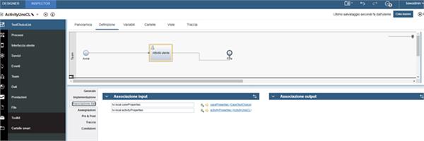

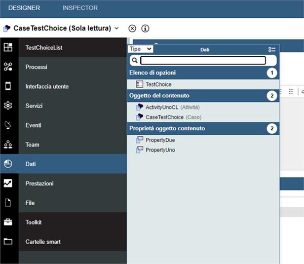

  • 9.  RE: How to use ChoiceList coming from Case Manager in BPM
    Posted Wed October 14, 2020 10:29 AM

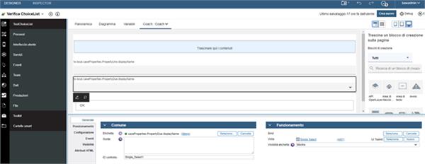

    Hi Paul, thanks for your interesting on this.
    Below some pictures about my simple solution:
    Waiting your sample…
    Many thanks!!!
    Marco Arrigoni

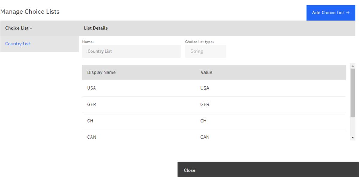

  • 10.  RE: How to use ChoiceList coming from Case Manager in BPM
    Posted Thu October 15, 2020 09:05 AM
    Hi Paul,
    According to my information we are still lacking support to bind the items in a single select coach view within a BPMN based case activity workflow to a choice list we "inherit" from the parent case. You have all kinds of config options for the single select CV but none is able to actually leverage the existing choice list.
    I already had  a brief conversation with Olaf Hahnl on that topic and understood that this is on the roadmap for an upcoming release of BAW but I just validated on the DBA 2.9 image that it is still not implemented.
    As an example, I took the "Legal Documentation Review" Case Solution from the DBA 2.9 image and added a choice list in Case Builder for the "Entity Country" property.
    When assigning it to a "single select" coach view it appears like this:
    But none of the available options allow you to leverage the existing choice list item to be used as the items for the single select CV.
    In fact, the only solution right now is to define exactly the same display names/values in a static list configured at the level of the CV or to implement a custom service which would retrieve this information from the choice list defined at the level of the CPE (which means in fact regular coding and breaks our low/no code message).
    Michael Kirchner

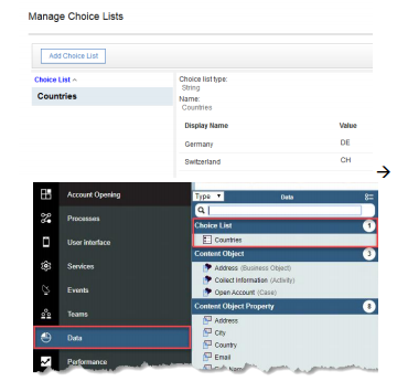

    All
    Here is a detailed description how to get Choice List based input restrictions in Coaches:
    Box
    Box remove preview
    Box
    View this on Box >
    PaulPacholski
    Offering Manager | Digital Business Automation
    IBM Canada Ltd.

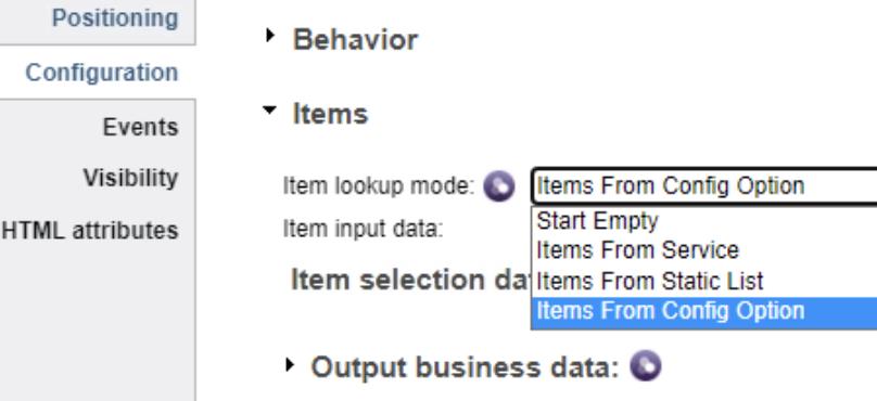

  • 17.  RE: How to use ChoiceList coming from Case Manager in BPM
    Posted Thu October 15, 2020 08:59 PM
    Edited by Thong Huynh Mon October 26, 2020 11:33 PM
    Hi all,
    I spent some times to poke around.
    So I have tried everything and still not able to get the ChoiceList values to display in BPM.
    First, I was able to see the list auto-populated in a Coach View configuration option if I define that option's type to be a HousingStatus type
    The config setup is like this
    I concluded that this is one usage of ChoiceList in BPM whereby you can manipulate your CV based on the values dictated by the ChoiceList.
    One example of this is a Chart CV in which you can choose from config option a 'chart type'. If you choose 'Pie Chart', the CV will display a pie chart. If you choose 'Bar Chart' and CV will display a bar chart instead. This action is only for Process/Case Designer rather than the end user.
    But this is not what we're looking for in this thread. We want the list to be available to end users using low code techniques.

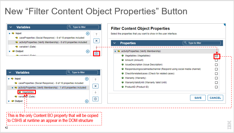

    We are adding a new Case Sync option in WebPD CSHS page editor 22.0.2 that allows you to see any deltas between the case model and the views on the canvas and select the ones to update without having to do the delete/re-add trick

    When you drag a case property from the case content object that is exposed into the process task, it will automatically add the choice items defined in Case Builder.
    You can then use the Case Sync icon at the top of the editor to update the static list if you make changes in Case Builder.

  • 26.  RE: How to use ChoiceList coming from Case Manager in BPM
    Posted Thu April 17, 2025 12:14 PM
    It is the Folder/spinner icon
    DAVE PERMAN

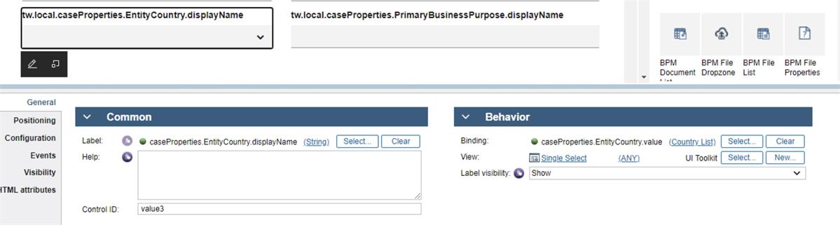

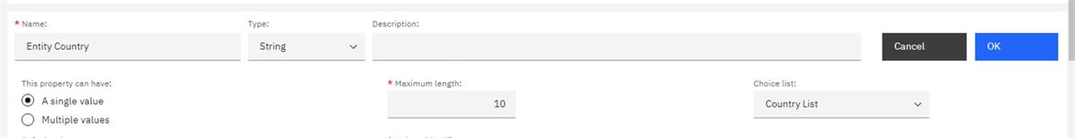

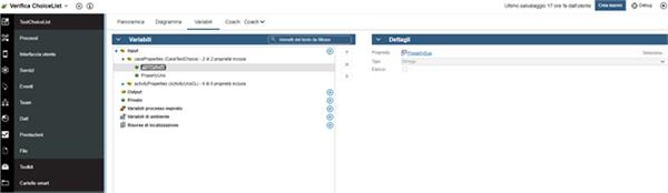

  • 27.  RE: How to use ChoiceList coming from Case Manager in BPM
    Posted Fri April 18, 2025 03:44 AM
    Hello DAVE,
    I think you are using a higher version of BAW.
    I don't have this icon in my version(BAW v21.0.3),please see in attached the view that i have.
