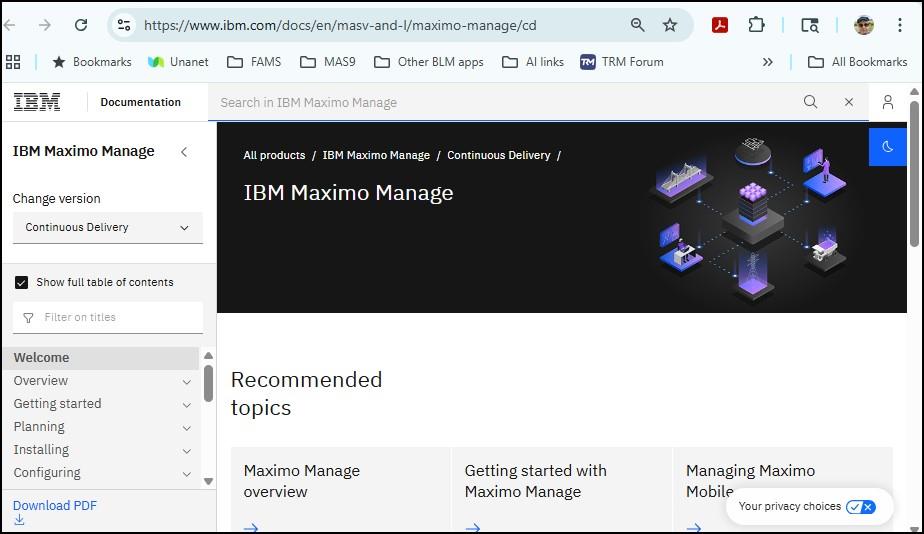

    Posted 07/22/25 10:47 AM
    This link appears to be broken - it shows generic IBM page and nothing about doclinks. Can you please correct this link?
    Thanks!
    Galina Leonova
  • 9.  RE: How to setup DOCLINKS in MAS Manage
    Posted 07/23/25 12:49 AM
    Hi,
    Updated link: https://www.ibm.com/docs/en/masv-and-l/maximo-manage/cd?topic=libraries-configuring-storage-attached-documents
