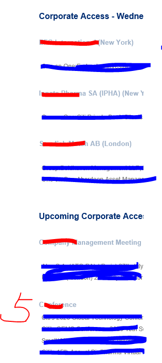

    hi all,
    I have use 'section' to format my report into 3  sections
    the red part is 2nd layer, and blue part is 3rd later. Sorry i have to hide the data here.
    Now the issue is the space between 2nd and 3rd layer are too wide, except for the 5th section at the bottom.
    I tried to adjust the height in 'Size & overflow' and 'space & breaking' on the 2nd layer and 3 layer but none of the works.
    I don't under why the 5th section at the bottom looks perfect, although the settings are same.

    You can remove class property to remove default section formatting and apply padding as necessary.

    thanks Buddhi .
    I did remove the class from the whole list and all 3list headers.
    Then i tried to apply 'Size & overflow' and 'space & breaking' , I changed them to be 1 or 0.5 px, but still wasn't able to remove the additional space.
    However if I increased them to 100px, it did enlarge the space.
    When you said 'padding', were you talking about same things?
