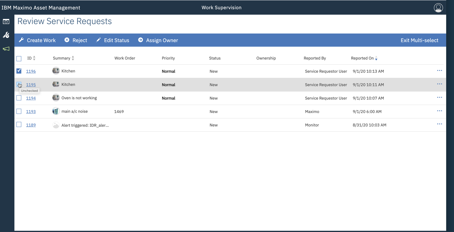

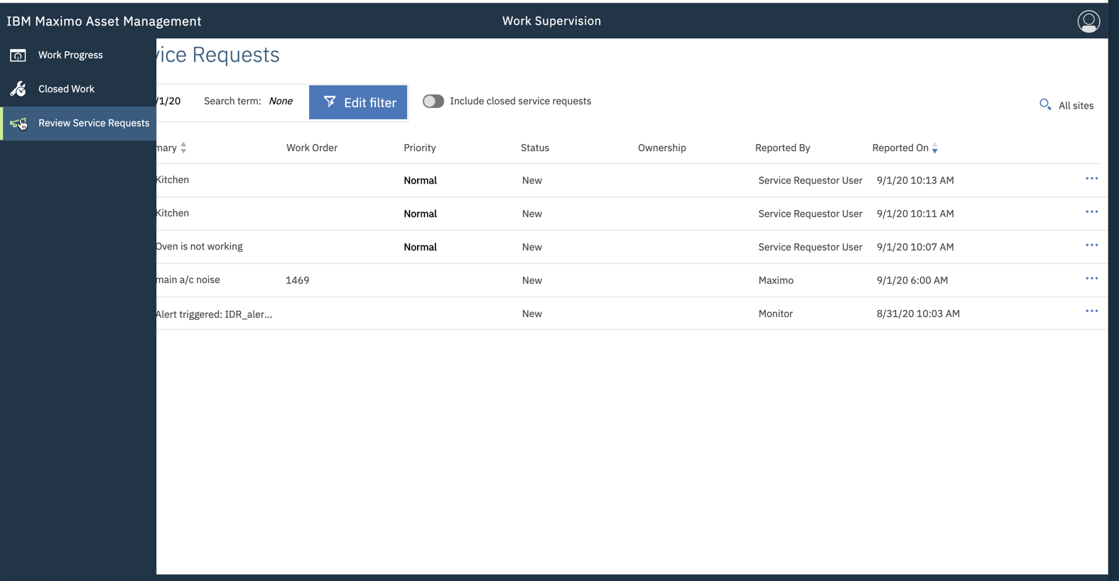

    Posted Tue September 01, 2020 10:28 AM
    I recommend using the Supervisor Work Center to review and process Service Requests.  Select the icon, Review Service Requests, that looks like a megaphone on the far left.  You can review, edit and process Service Requests (including Creating Work Orders) here.
