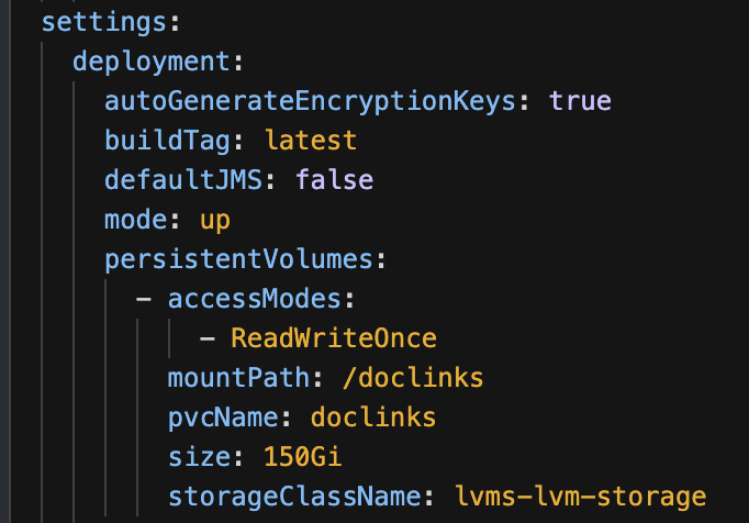

    This process is easier than you might think. Simply define your PVC within the ManageWorkspace Custom Resource Definition (CRD) that's part of your Manage operator. Here's an example of how it's configured in our single-node setup:
    If you're using a full cluster, there's no need to define the accessMode, as the default is ReadWriteMany (RWX). Once you save your Custom Resource Definition (CRD), the Kubernetes API server will detect the changes in your application. When it sees the new PersistentVolumeClaim (PVC) definition, it will automatically generate and bind the PVC for you. From there, you can set it up just as you would in earlier versions.

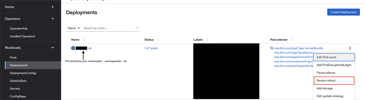

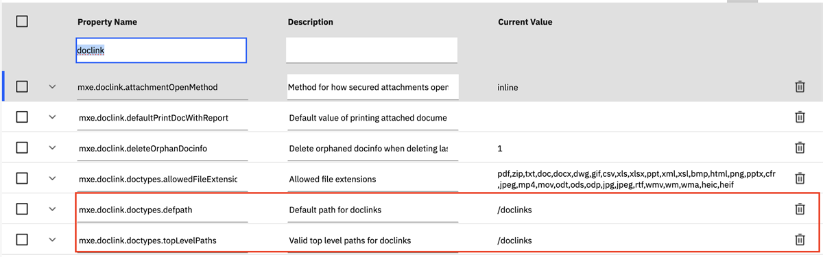

    Once the system properties are configured to your specifications, simply restart the rollout on the WebSphere pod. That should complete the setup. If you run into any issues, feel free to reach out.
