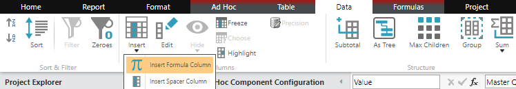

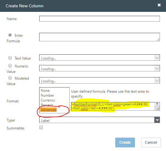

    Hi Mike,
    You need to add in a formula column;
    Enter the formula to equal your value column and set the format as follows;
     =NumberFormat({$_},"<font color='green'>#,###.00;<font color='red'>-#,###.00")
    Further information can be found at NumberFormat function
