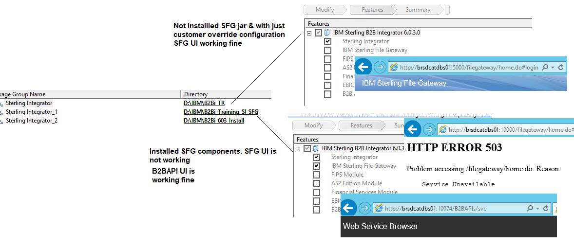

    Hi Indu,
    Attaching package installation & UI snippet for reference.
    Snippet showing IIM install packages, installation directory & UI error

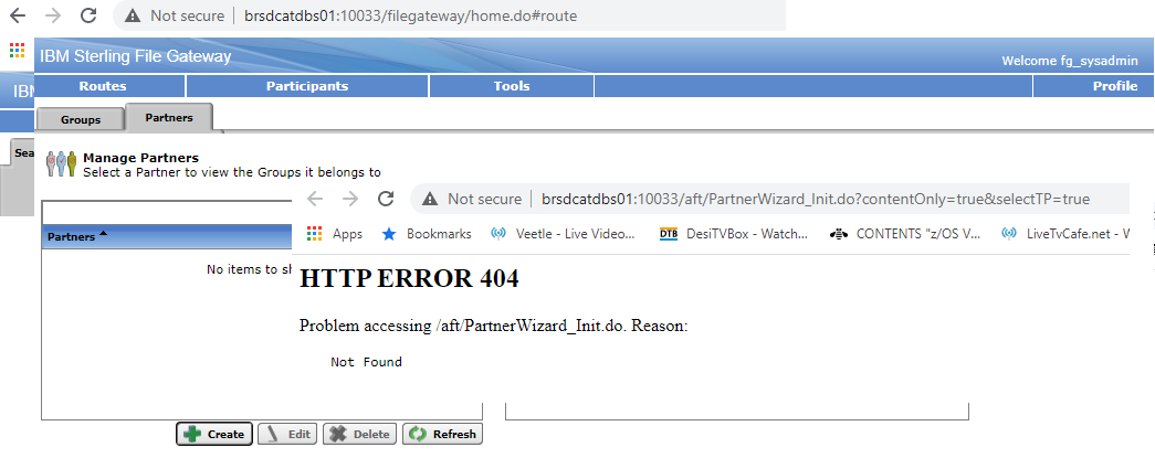

    Rajasekhar,
    Yes, i was able to access SFG before installing any plugins. As i mentioned http://<Host>:<base+74>/B2BAPIs/svc URL is working good however we are unable to access /filegateway url. Yes as i workaround we have hosted /filegateway URL on HTTP/S server adapter however when we are trying to create a  partner profile page is getting error out as it trying to access /aft url over HTTP/s adapter port. please refer below snippet

  • 7.  RE: Filegateway URL failure - HTTP ERROR 503
    Posted Fri September 18, 2020 12:40 AM
    Atul,
    That's expected. Please configure aft.war as well on /aft. If you prefer to access SI from SFG then configure admin.war as well on /dashboard.

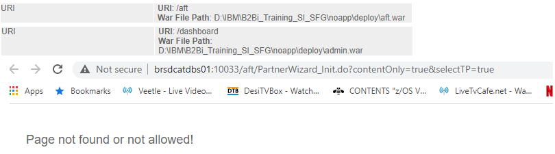

    Rajasekhar,
    Thanks for input, i did said configuration and tried to access Create Partner URI but its failing with below message.

  • 9.  RE: Filegateway URL failure - HTTP ERROR 503
    Posted Fri September 18, 2020 02:53 AM
    Edited by System Admin Wed March 22, 2023 11:48 AM
    If all 3 wars configured on the same HTTP/S adapter & port, it should work.
    - /filegateway => filegateway.war
    - /aft => aft.war
    - /dashboard => admin.war
