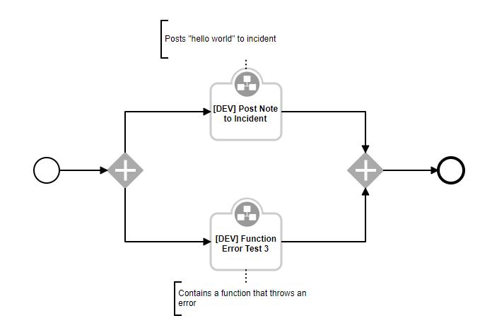

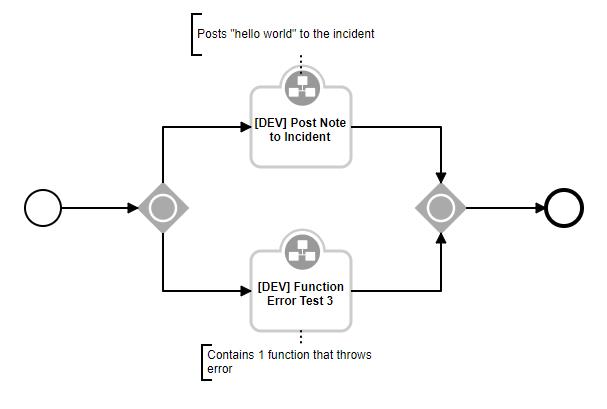

    Parallel Gateway Parent Workflow 1
    To test, we created a simplified version of our problem. We made a parent workflow that contains two child workflows running in parallel. One of the workflows posts "hello world" to the incident. The other workflow contains a function that only throws an exception, which is handled with the yield FunctionError() method within resilient circuits.
    parallel-parent-workflow

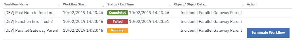

    After invoking this workflow with a menu-item rule, [DEV] Post Note to Incident successfully posted "hello world" to the incident. The function inside of [DEV] Function Error Test 3 failed, causing the whole workflow to fail. However, when checking the status of the workflows within the incident, we found the following:
    parallel-parent-workflow-1-status
    This fits with what we are seeing in our environment. We'd prefer if the workflow [DEV] Parallel Gateway Parent would have a status of Failed/Complete rather than Running. We've noticed the workflow will have a status of Running until it eventually changes to Suspended.

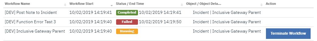

    Again invoking this rule via a menu-item rule, we got the following output from the workflow status page:
    inclusive-parent-workflow-1-status
    However, this was different than the result we had gotten in our environment doing a similar test (replacing parallel gateways in the parent workflow with inclusive gateways).

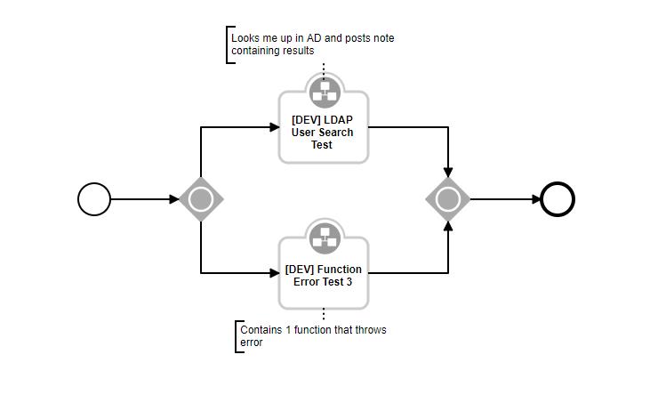

    Inclusive Gateway Parent Workflow 2

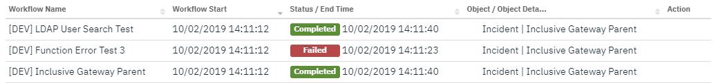

    We created the same workflow as above but this time replaced the child workflow [DEV] Post Note to Incident(which only contained a script) with [DEV] LDAP User Search Test, which is a workflow that contains an LDAP Search function configured to look me up in AD.
    inclusive-parent-workflow-2We ran this workflow like normal but this time we got the results we desired:
    inclusive-parent-workflow-2-status
    What we gathered was that the difference was the workflow that failed, [DEV] Function Error Test 3, returned before the successful workflow [DEV] LDAP User Search Test finished.
    Again this is the behavior that we desire, as some of our child workflows will sometimes error out and it results in a parent workflow that's still Running, and remains running until we manually go through and close out all of the workflow instances (identical to the first two test results). We have created a function that we can trigger on incident close to go through and close all running workflow instances associated to that incident, but we're still curious why this happens.

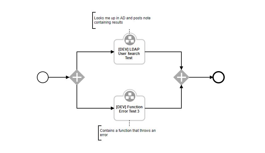

    Parallel Gateway Parent Workflow 2
    We remade the original workflow but this time replacing the child workflow that contained a script posting a note with a child workflow that looked me up in AD via the LDAP Search function.
    parallel-parent-workflow-2

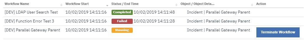

    Here's the workflow status after the parent workflow was run:
    parallel-parent-workflow-2-status
    So the failing child workflow returning before the successful child workflow had no affect on the parallel gateways.
