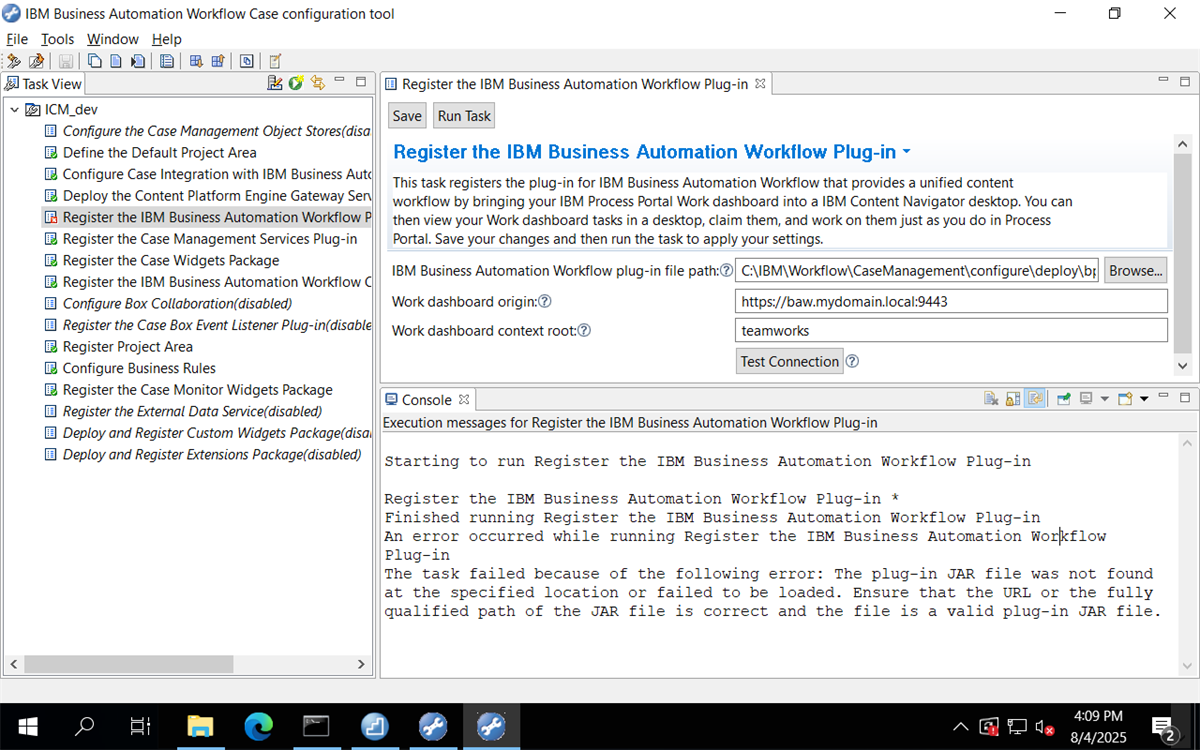

    I have setup a BAW 25 environment with external ICN and CPE. Originally I configured the network shared folder in the CPE server (\\CE\sharedproperties), everything is running fine, able to run all the tasts in Case Configuration Tool (CCT), and the ICN was running fine with all the necessary plug-in installed. Now I wanted to change the network shared folder to my BAW server.
    I created a new shared folder in my BAW server (namely \\BAW\sharedproperties) and copy all the files in the old network shared folder to the new folder, mapped the new folder to CPE server, also perform the "BPMConfig -update -profile DmgrProfile -de WorkflowCenter -component CaseManager -networkDirectory" as per the instruction (Changing the network shared directory - IBM Documentation)
    Now when I try to run the CCT Task to register the Plug-in, I got the "Plug-in JAR not found at the specified location or failed to load"

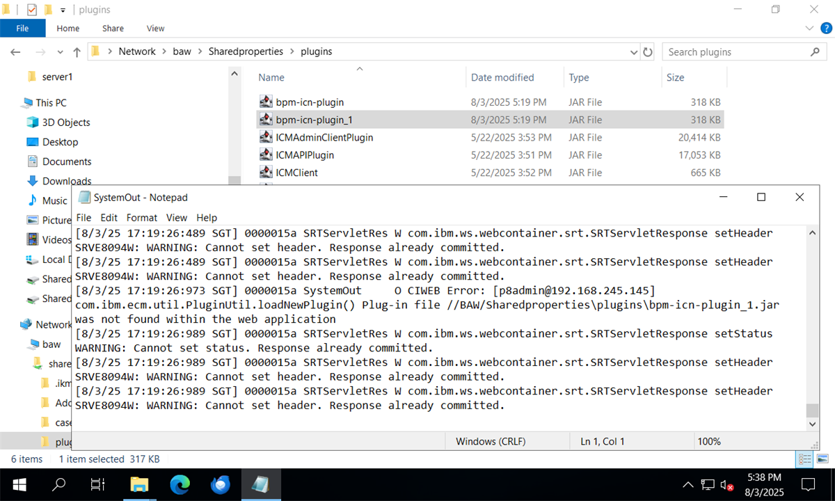

    I doubled check the network share drive, all the plug-in jar files are located in the folder.
    I did found an error in the systemout.log of CPE server, saying it cant find the jar file within the web application, but I have no problem accessing the network folder from CPE server.
    Anyone got any idea what was going on and how to solve this?
