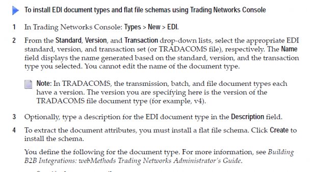

    Thanks for the reply. I can install the EDI X12 from the admin page. But I want to install XML and Flatfile, can you tell me how to do it? I cannot see it in the TNcosole although it can be created on the doumetnation.

    you have to create XML and flatFile TN Document types… for creation you can have a look at the TN users guide for more information.
