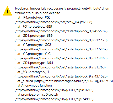

    I have a problem when I use javascript in the active report prompt pages.
    while I am editing the active report I run the report for test it, it works
    After that I save the report. I run the report and receive the error
    Cognos Analytics 11.0.12 on windows environment
    error when run active report with javascript
    can someone help me?
    Thanks
    Massimo

    @Massimo Deambrogio Can you provide a copy of the report spec? I would like to see how the report is authored and the custom JS being used.​

    @Massimo Deambrogio You may be running into a variation of defect - PH02628: ERROR WHEN RUNNING A REPORT TO EXCEL FROM PORTAL WHEN REPORT CONTAINS JAVASCRIPT IN CUSTOM CONTROL
    I will test and validate if it is fixed for Active Reports in 11.1.4

    @Massimo Deambrogio I tested and can confirm the issue has been fixed for Active reports in 11.1.4. This has also been fixed in 11.0.13 FP2​.
