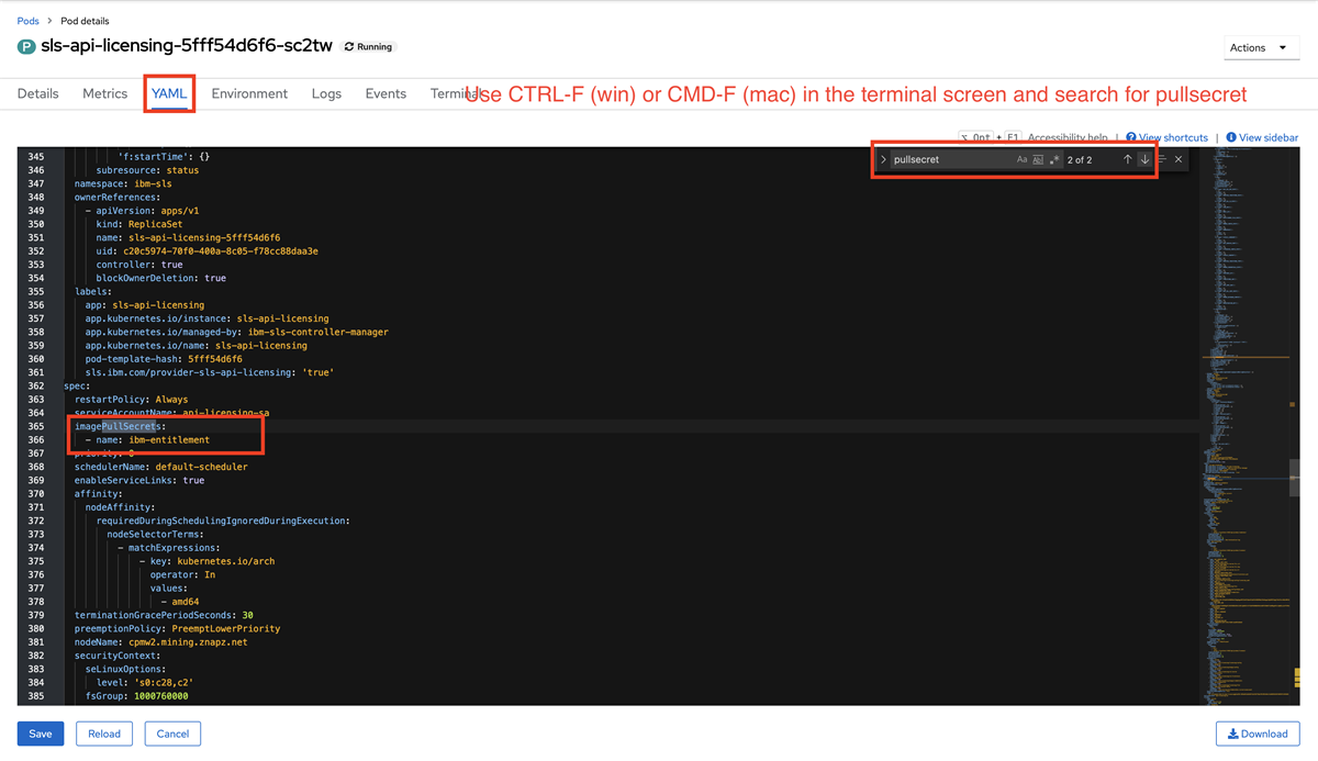

    Please check if the ibm-entitlement-key secret exists in the SLS project. Seems that this secret is not (yet) added. You can easily check to which pull secret is referred to by opening the yaml file of the pod that is not running and search for pullsecret. Check if this pullsecret exists in the project / namespace where the pod is running in.

    ibm-entitlement is there but not  ibm-entitlement-key
    Muhammad haris bin javaid
  • 8.  RE: Error in installing MAS8.9 Using ansible palybook
    Posted 10/01/23 06:11 AM
    Hi
    I check pod is using ibm-entitlement  secret
    Reagrds

    Please check in the pod that is running into the imagepullbackof error to which pull secret is referred to:

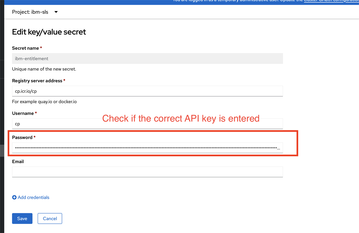

    Check also whether the correct API key in the ibm-entitlement secret is entered:

    All of these are correct
