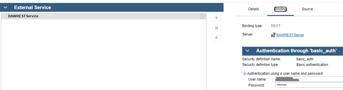

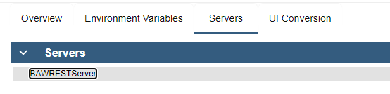

    I have a REST server with all the necessary settings:
    an External service:

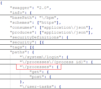

    The operation name "processes" is written in the swagger file:

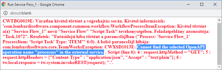

    But I get the error "Cannot find the selected OpenAPI operation name "processes" in the external service.":
    I don't understand this... How could I call the operations of the BPM REST?

    This is probably mistake in your swagger file  - operationId is missing.
    e.g.  for such definition of deleteProcess (fragment from swagger)
    "paths": { "/process/{processId}": { "delete": { "summary": "delete process", "description": "delete process instance", "operationId": "deleteProcess", "produces": [ "application/json" ], "parameters": [ { "name": "processId", "in": "path", "description": "process id to delete", "required": true, "type": "integer" }​
    Your code should look like:
    request.externalServiceName = "BAWRESTService"; request.operationName = "deleteProcess";
    So if you are using operation name "processes"  - you have to define also  operationId "processes".
    Path is not the same as operation name.

    … and if you use out-of-the-box BAW swagger file  ( from /bpm/docs)  this operationId is called getProcess
     Fragment of out-of-the box file:
    "/processes/{process_id}": {
                                  "get": {
                                                 "summary": "Retrieve a process instance.",
                                                 "description": "Retrieves detailed   ... ",
                                                 "operationId": "getProcess",
    so
    request.operationName = "getProcess";
