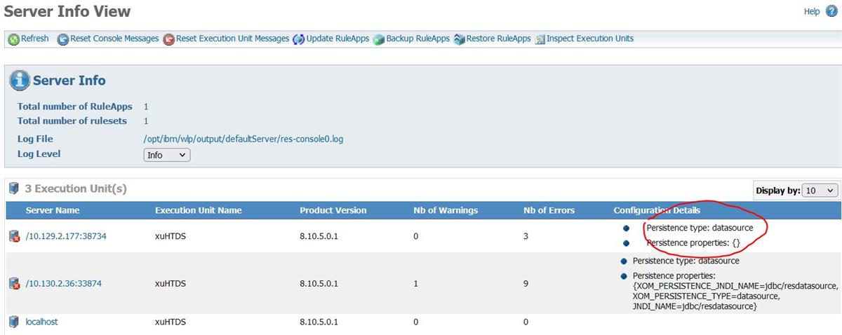

    Note that I deployed the 2 replicas of DS runtime in the same Helm release, so they should have exactly the same configuration, however I can appreciate some differences in DS console. But same exception is raised in the 2 runtime replicas.
    ¿My this be the cause fo the error?

    As for the DS console UI inconsistency between the 2 servers configuration, we are still investigating but this does not appear to be related.
