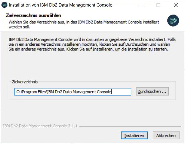

  • 5.  RE: DMC Error while starting up
    Posted 05/16/20 09:38 AM
    Hi Yun Bo,
    just out of curiosity I did a fresh install of DMC 3.1.1.0 with the GUI installer (=aka as my customer did).
    The default installer path containes loads of spaces. :-(

  • 6.  RE: DMC Error while starting up
    Posted 05/18/20 06:15 AM
    Hi Roland,
    This error log information will not cause the DMC server to fail to start. If you want to avoid this error log during startup, do not include spaces in the installation path. Thanks for your feedback and hope to fix this issue in future release.
