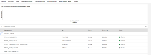

    Scenario 1:
    While having set an active full_blackout or monitor_and_alert_blackout on a connection profile the Event Monitor Profile screen shows the various event monitors as <Enabled> but in a greyed out fashion, i.e. as de-activated. For instance:
    Event monitor status display during activated blackout
    At the very same time I still see the event monitors in the DB2 monitored database in status <active>:

    Scenario 2:
    Another confusing situation I frequently see after releasing a full_blackout or monitor_and_alert_blackout is that for instance the locking event monitor does not come up properly or its status is not displayed correctly.
    On Event Monitor Profile screen the Locking event monitor is enabled and displayed in green:
    Event Monitor enabled and active
    But when listing the event monitor status on the summary screen, the Locking event monitor is still shown as disabled:
    When creating a lockwait in the monitored database the lockwait does not get displayed in DMC Locking metrics, but it is visible in the SYSIBMADM.MON_LOCKWAITS view.
    In the monitored database I can see the following event monitor status:
    SELECT SUBSTR(EVMONNAME,1,30) AS EVMON, CASE WHEN EVENT_MON_STATE(EVMONNAME) = 0 THEN 'INACTIVE' WHEN EVENT_MON_STATE(EVMONNAME) = 1 THEN 'ACTIVE' END AS STATE FROM SYSCAT.EVENTMONITORS
    EVMON                          STATE
    RTMON_EVMON_ACTIVITIES_1662035 ACTIVE
    RTMON_EVMON_LOCKING            INACTIVE
    RTMON_EVMON_STATS              ACTIVE
    RTMON_EVMON_UTILITY            ACTIVE
    So to me it looks as if the Locking event monitor is actually disabled, although shown as enabled in DMC.
    The only way I can remediate the situation is by disable/re-enable the Locking event monitor on the monitoring configuration screen in DMC. Simply logout from /login into the DMC web console does not help fixing the conflicting displays.
