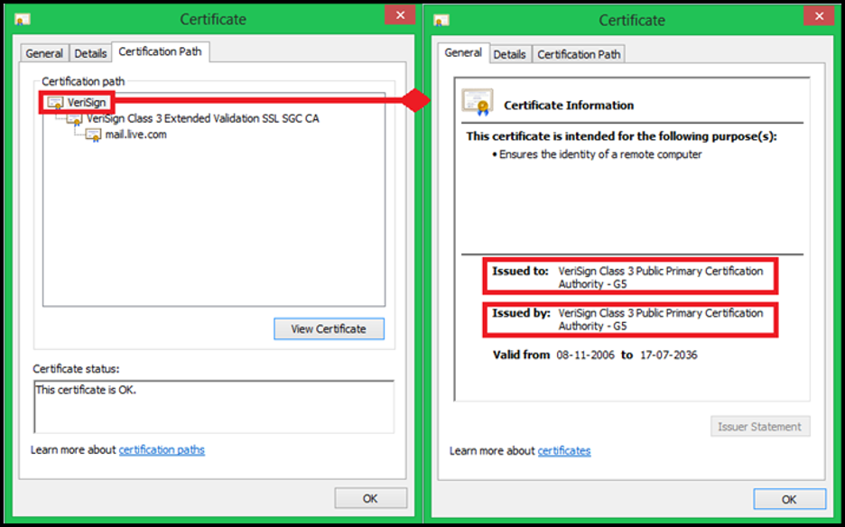

    An example of a public root CA in a Windows interface.
    I also have a faint memory that you should also see the associated root certificate in *SYSTEM store after you import the client certificate that comes with the root one. Please look if you see one (but you may need to be informed of the root certificate's name to recognize one).  If you do not see the root one, then you cannot use CA Trust List.   Since you mention your application already works without a CA Trust List, you can decide if you really need a CA Trust List. If so, you ask for a new one with a root certificate.

    Note that if you are only adding in the Root CA certificate, you might be seeing a failure to validate because an intermediate CA is also needed in that CA trust list.
    In the example posted by Satid, there is a "VeriSign" Root CA which issued the intermediate CA certificate named "Verisign Class 3 Extended Validation SSL SGC CA".  That intermediate CA issued the "mail.live.com" certificate.  If the client application received the "mail.live.com" certificate during TLS handshake, then you would need both the VeriSign Root and Intermediate CA in the CA trust list in order to correctly validate the certificate.
