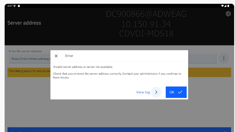

      |   view attached
    Hi @Steven Shull,
    We are using Maximo 7613 with Mobile 9. Managed to configure SSO with Azure AD and login working perfectly from web application.
    Where as in mobile application it's not redirecting to the SSO log-in page, instead it shows as "Invalid server address or server not available" message. I'm attaching the web sphere trace log for reference. Appreciate if you can go through and let us what's wrong there.
    We are using android devices with out any MDM.
    Thanks,
    Suresh.

  • 9.  RE: Difference in Azure AD SSO behavior between Maximo browser and Maximo Mobile for EAM
    Posted 11/04/25 11:01 AM
    Hi Mohan, could you check if maximo property mxe.useSAML is set to 1.
