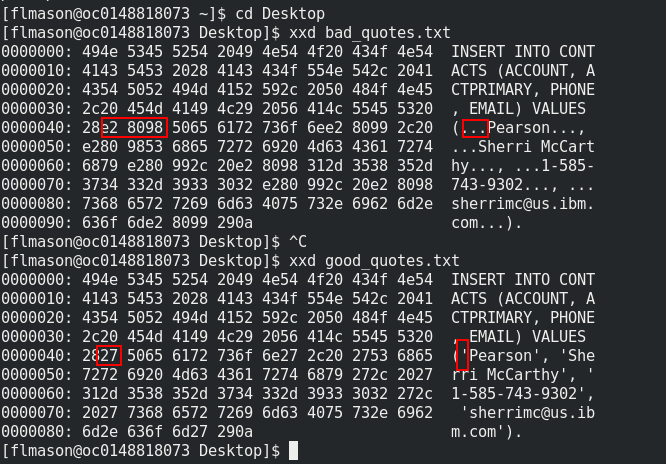

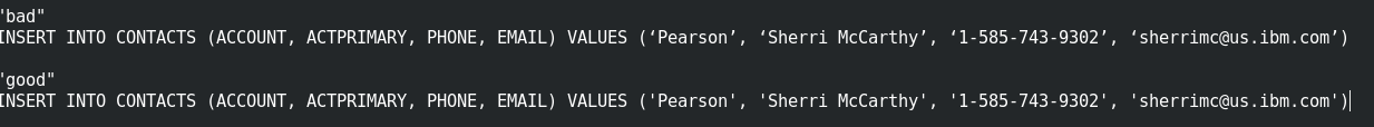

    As an aside, here's what we're talking about it anyone wants to see it...
    Here's a screen clip of the "bad" and the "good"...
    I then cut & pasted them into "bad_quotes.txt" and "good_quotes.txt" and ran them through xxd to see what Alan was pointing out...Interestingly... that gives even different looking results... in that a quote isn't displayed in the text side of the xxd output.

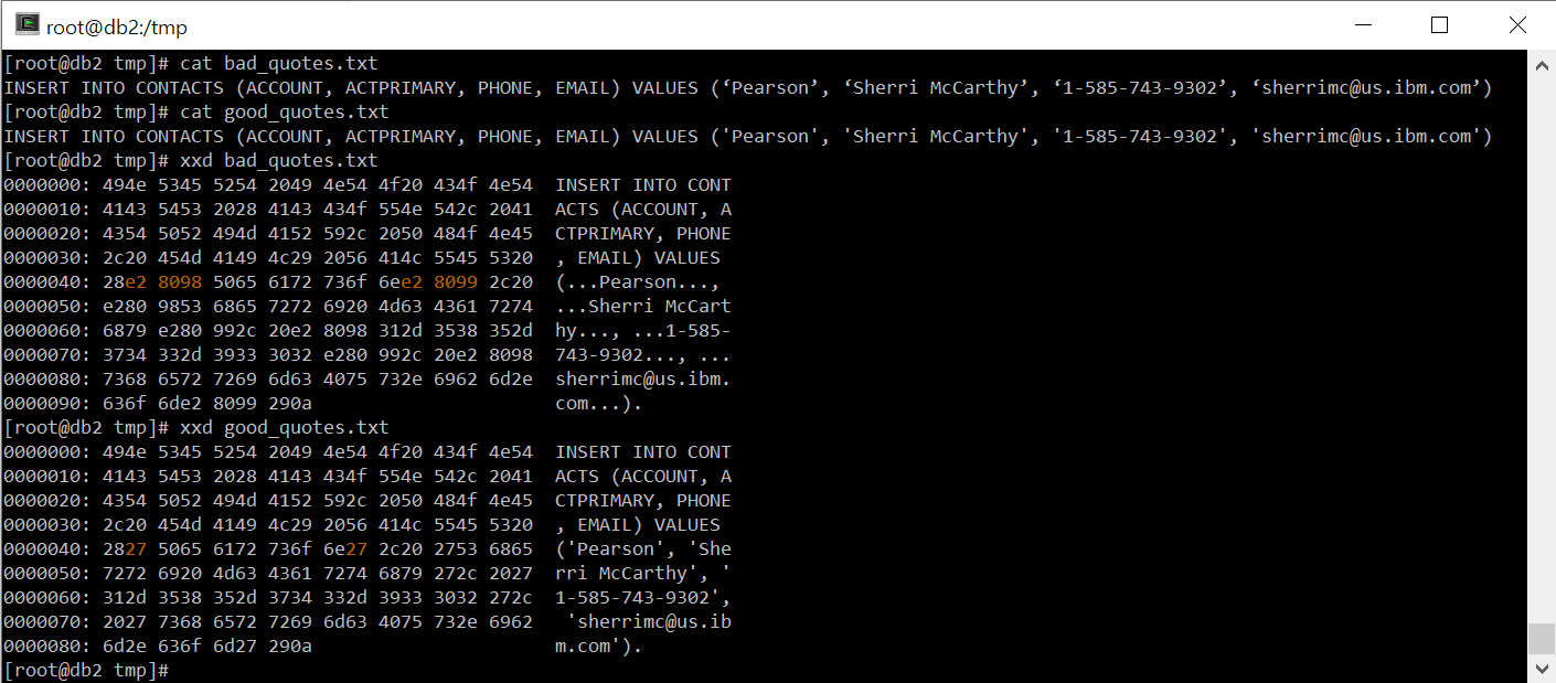

    Hello Frank,
    I tested it with the same text as your hexadecimal code.
    But I don't know why the single quote turns into ascii code 145/146 when you type the text in openoffice.
    -- bad_quotes.txt
    ‘ (left single quotation mark)   : UTF-8 0xe2 0x80 0x98 / extended ASCII 0x91 (145)
    ’ (right single quotation mark) : UTF-8 0xe2 0x80 0x99 / extended ASCII 0x92 (146)
    -- good_quotes.txt
    ' (single quote)                        : ASCII 0x27 (39)
    SangGyu Jeong
