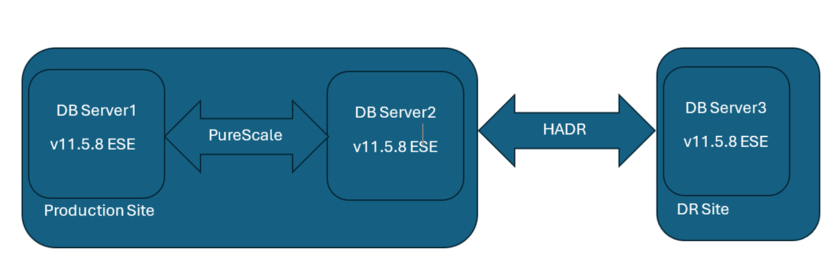

    Is it  possible to deploy an IBM Db2 pureScale Cluster deployment from the production site and a Db2 Standard Installation at the dr site then  connect the two using HADR for High Availability and Disaster Recovery.
    Sample Db2 deployment plan with hadr

    You establish a HADR between two Db2 pureScale clusters; so obviously the answer is no.
    Check also:
    https://www.ibm.com/docs/en/db2/11.5?topic=environments-restrictions-hadr-in-db2-purescale
