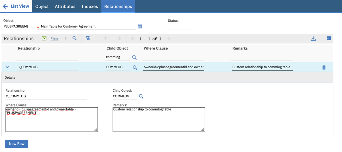

    1.New custom relationship between objects PLUSPAGREEMENT and COMMLOG
    Where Clause: ownerid=:pluspagreementid and ownertable = 'PLUSPAGREEMENT'

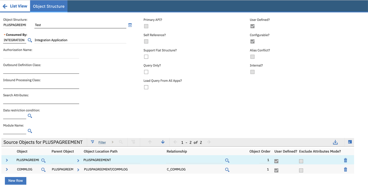

    2. Custom Object Structure witch objects PLUSPAGREEMENT and COMMLOG

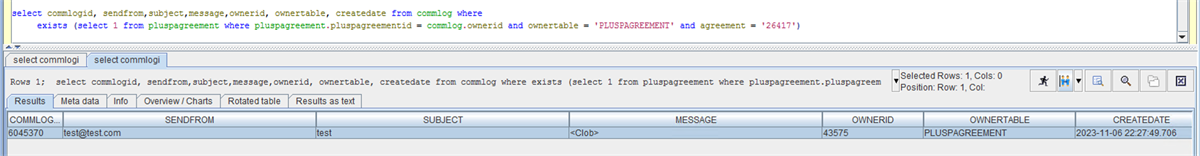

    Result in database:

    Thanks! I was missing the source object for COMMLOG in the agreement structure. I thought I had checked that but I guess not. It is working now.
