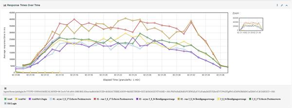

    We use jMeter for performance and also functional testing. It lets you record a click path, define threads for simulating parallel users clicking, each execution is logged and depending on your settings when jMeter test finishes it automatically creates a dashboard with the results.
    In the graph you can see:
    * Rampup time is 5 minutes, the login sequence for the 100 users starts at 21:08 and stops at 21:14
    * Queuquing starts around 70 parallel users
    * No errors in executions over time
    * Min and Max response times for distinct reports
    * Evolution of response times when more and more users execute in parallel
    Mail me, if you would like more information or a screensharing for getting jMeter to run your first testcase.
