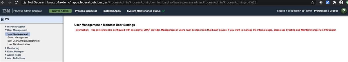

    Installed CP4Automation on OpenShift 4.3. Successfully installed BAW.
    I'm able to login to the BAW admin client and ACCE without any problem.
    When I try to login to PHP LDAP using admin user (cp4admin) I get an invalid credentials error.
    I'm attaching the snaphot of the error.
    (What is the right login for CP4Automation demo/evaluation install)

    Thanks for the response. Yes, you are correct I'm trying to login to PHP LDAP admin website.
    I tried DN the cn=cp4admin,dc=example,dc=org and also tried cn=cp4admin,dc=federal,dc=pub,dc=ibm,dc=gsc (according to domain address) nothing works.
    My purpose of login to the LDAP admin is to add more users/group as the Process Admin is configured to use LDAP as the user registry
