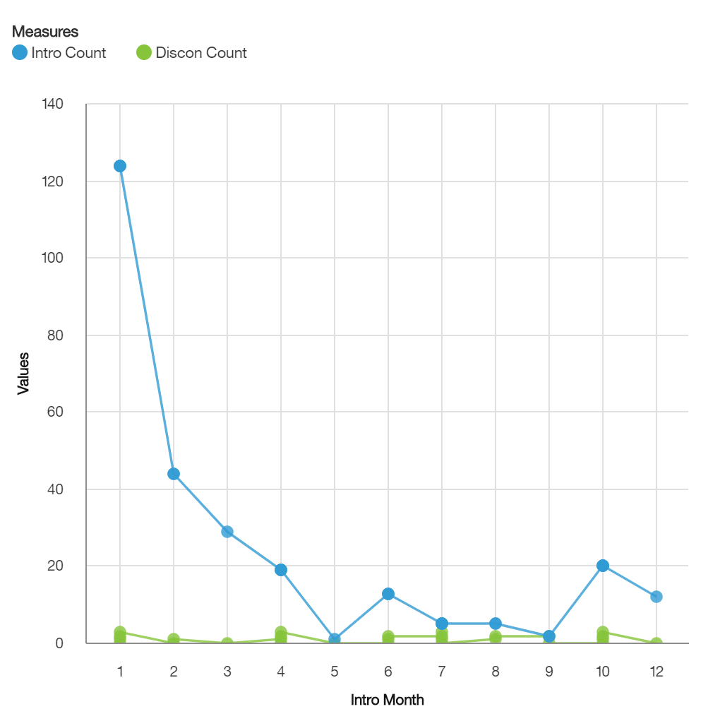

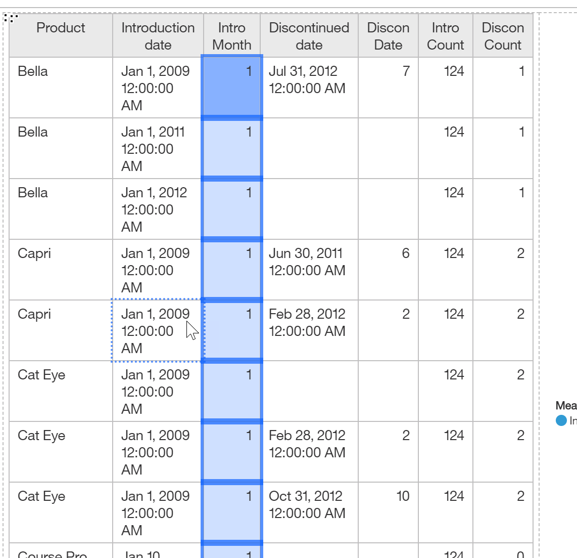

    Create two new items called MonthCreate and MonthClose and use the function extract to pull out the month number.  extract(Month, [CreateMonth] or [OpenDate]).  Then do a count on each to sum them up.  Count(MonthCreate or MonthClose for ID).  That will give you a consolidated count for each.  You can then add them to a chart and see the totals for each month.
    I used the go sales data and product intro and discontinued date to build the sample below.
    Tabular/List Data
    Line Chart
    Todd Schuman

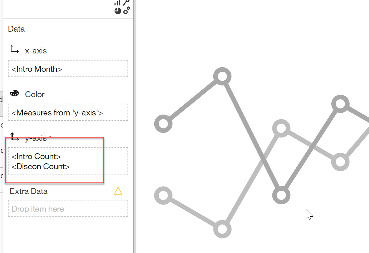

  • 11.  RE: Count based on 2 different dates
    Posted 11/03/20 07:51 AM
    Hi Jenifer,
    There is nothing special in the properties or data containers, just a list and 11.1 line chart viz.
    Line Chart
    What version are you running?  I am on 11.1.7 FP1.  I believe you would need at least 11.1.6 to take advantage of the multiple measures on a visualization enhancement that was added.
    Cognos 11.1.6: Our Favorite New Features - Senturus Blog
    If you are on an earlier version and/or can't upgrade, you would have to break it up into two queries and union them together with an additional text field that described the date as "Create Date" or "Open Date".  You would then use that field to drive the color or category.
    I can try to mock something up this way if you need more help.
