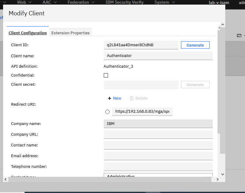

    Based on the 400 response from the /authorize endpoint, I would guess that although you're sending "AuthenticatorClient" as the client_id, the actual clientID is not set to that value.  Can you check this under the OIDC Client settings? Maybe a screenshot of that LMI page?

  • 8.  RE: Configured MFA but at the registration not able to see the qrcode.
    Posted Mon April 25, 2022 03:46 AM
    ClientID
    shivsantosh patil
  • 9.  RE: Configured MFA but at the registration not able to see the qrcode.
    Posted Mon April 25, 2022 06:28 AM
    Shivsantosh,
    From the screenshot I can see that your ClientId isn't "AuthenticatorClient".  It is "q2L8.....".  You need to put this ClientId into the redirect URL instead of AuthenticatorClient.

  • 10.  RE: Configured MFA but at the registration not able to see the qrcode.
    Posted Mon April 25, 2022 08:04 AM
    thanks jon,
    for helping again

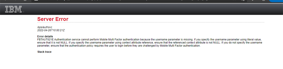

    my device is registered but Getting this error
    shivsantosh patil
  • 13.  RE: Configured MFA but at the registration not able to see the qrcode.
    Posted Tue April 26, 2022 09:51 AM
    Shivsantosh,
    Looks like you're using the default MMFA authentication policy.  This policy is configured to require the username to be passed as a query string when the policy is invoked.  Try adding &username=xxxxx to the trigger call to authsvc.
    If you want to be able to invoke MMFA as the currently logged in user, create a new policy which matches the default but leave the mapping for the username blank (and unchecked).
    Sounds like you're almost there...

  • 14.  RE: Configured MFA but at the registration not able to see the qrcode.
    Posted Wed April 27, 2022 01:54 AM
    Edited by shivsantosh patil Wed April 27, 2022 05:26 AM
    hi Jon,
    Now after removing the username in the MMFA initiate policy it showing me the mfa page but from my app i am not able to have pending notification. where should i make changes can i re scan the qr code again.
    please guide.
    shivsantosh patil
