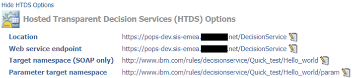

    The HTDS settings of the ruleset is pointing to the ingress route where the decisionserverruntime service is exposed and the execution of the HTDS test is properly balanced among all the runtime pods.
    HTDS
    Everything looks fine except the configuration of the management plugin in the local XU of the console that is configured to use JMX. This is why my guess is that exceptions are related to this.
