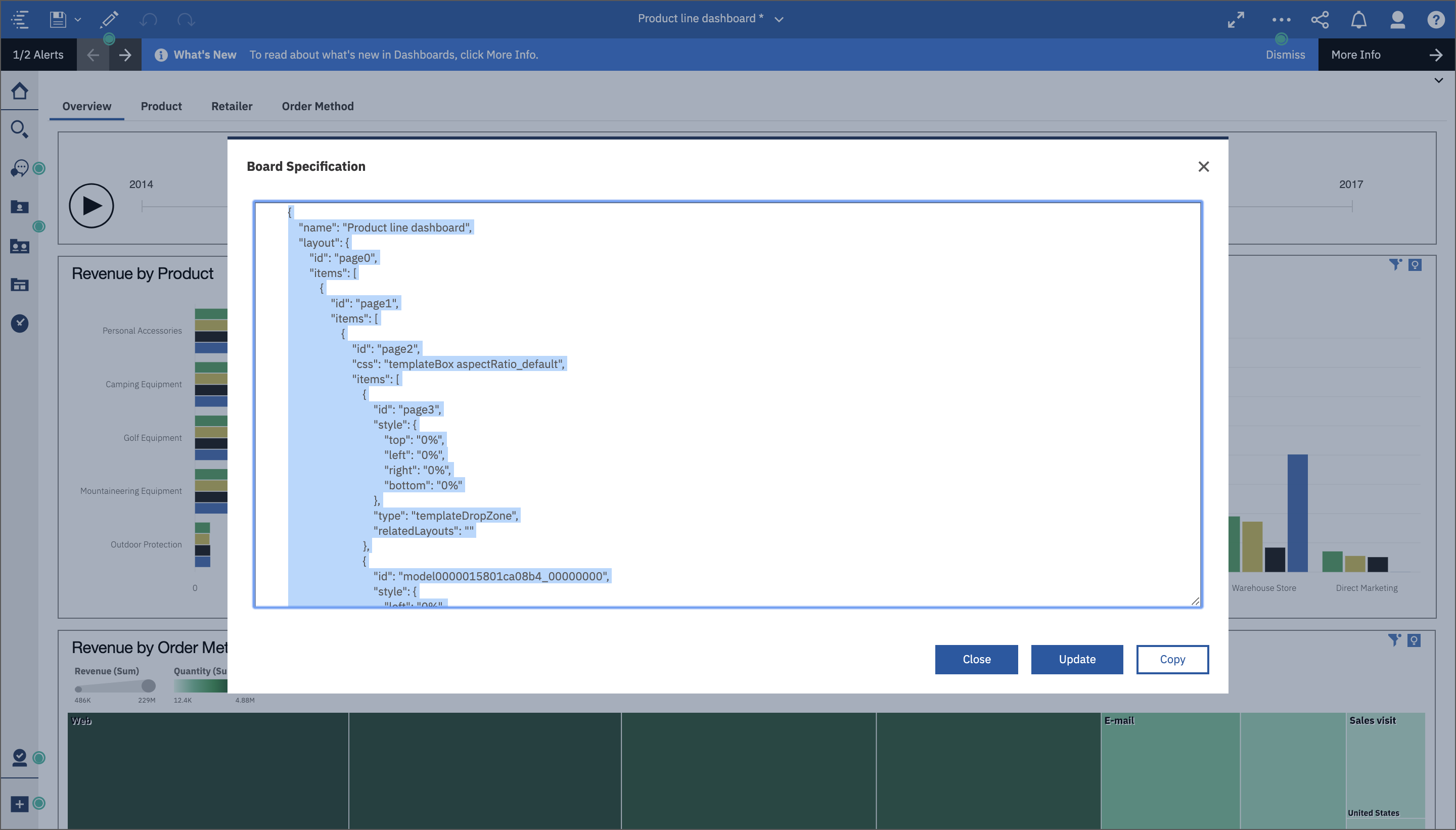

    Another tip with conditional formatting on crosstabs is to pull up the dashboard specs page and enter the values you want by hand:
    1) Hit CTRL + / + Q to view the JSON doc with dashboard specs
    2) In your browser, search for "conditional" to find the specs for the conditional formatting
    3) Update the values you want there
    4) Click update to apply changes
    This helps if you have many different categories or a large range of numbers and it's difficult to use the slider.

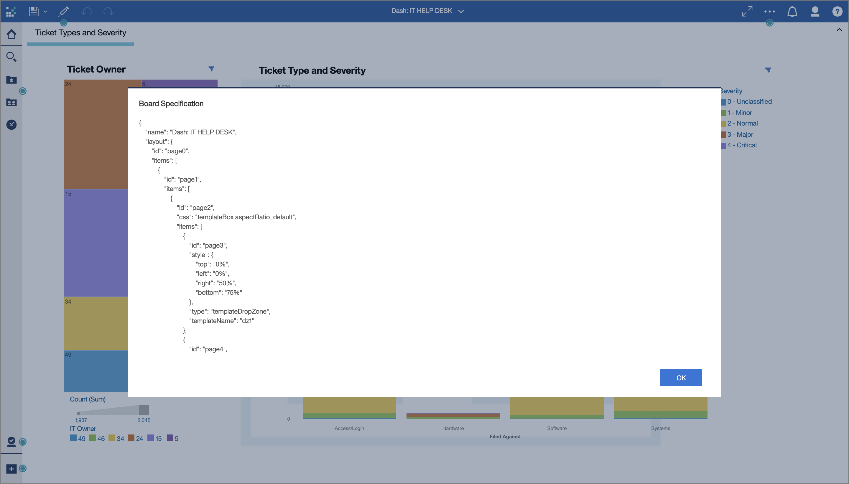

    Hi @Jenifer Broughton the CTRL +/+Q ​command brings up the dashboard specifications page in 11.0.13 (is read only), but I'm not 100% sure on whether it should be working in 11.0.10.  (See below screenshots of 11.0.13 vs 11.1.4).  This link doesn't show that command available for 11.0.10, but here are some other keyboard shortcuts for various versions: https://www.ibm.com/support/knowledgecenter/en/SSEP7J_11.0.0/com.ibm.swg.ba.cognos.ug_buxc.doc/c_ug_buxc_keybd_shtcts_dash.html
    (In 11.1.4, another way to do this is to select a widget/visual and hit CTRL+Period and you get a menu that allows you to select "Show Details" which will take you to the same page.)

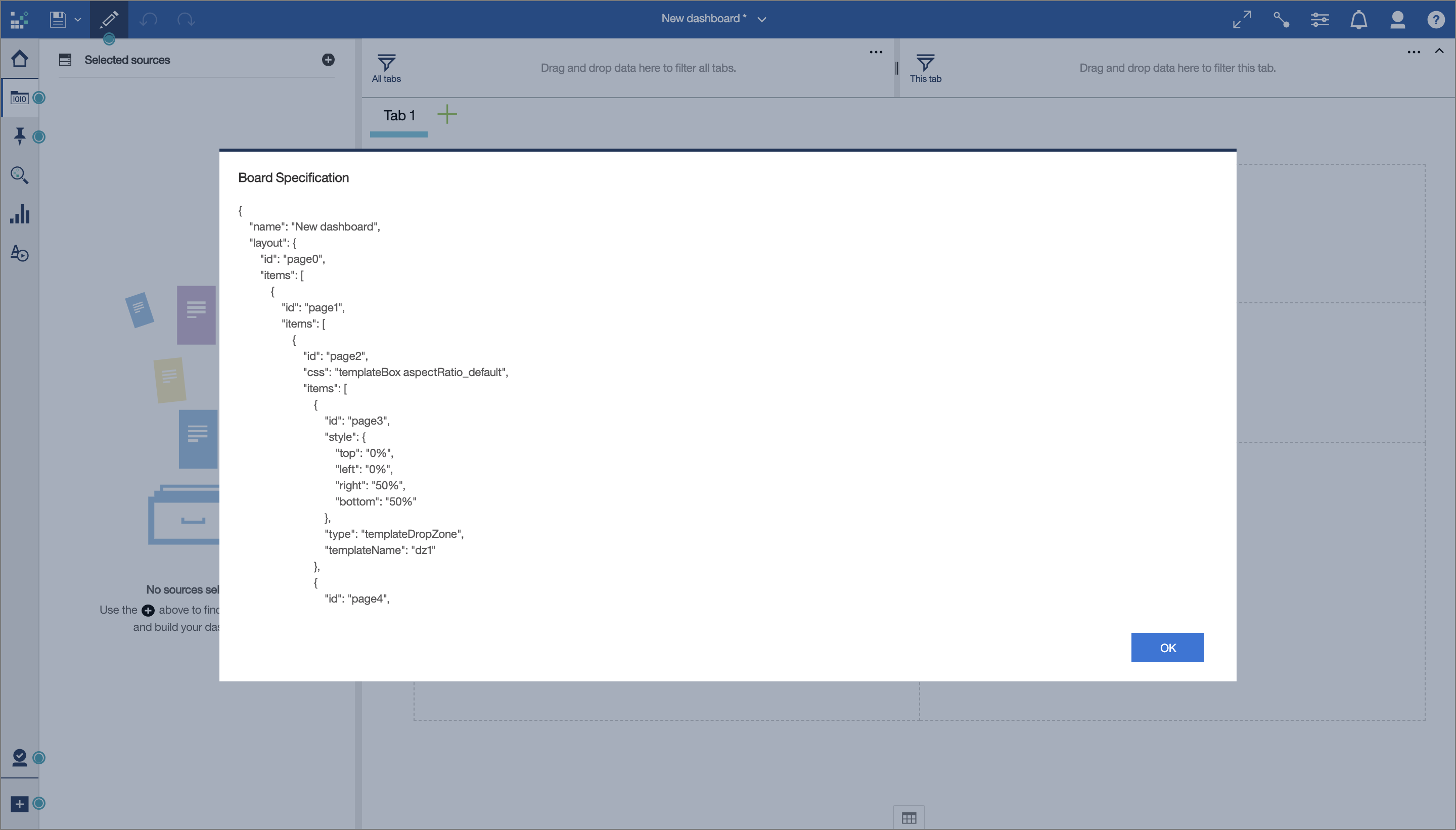

    Hi @Jenifer Broughton I just tested in 11.0.10 - the specs page is available if you enter CTRL+FWD SLASH+Q, but similar to 11.0.13, it is read only. See below:
