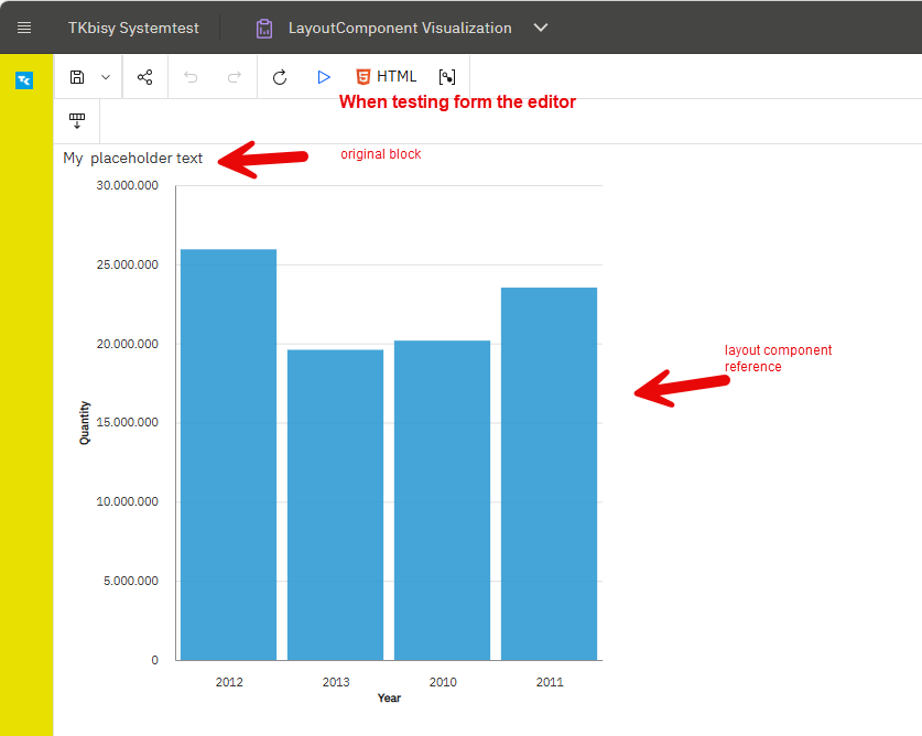

    Hi everybody
    In our environment, we use layout component references quite heavily. They are one of the killer features of Cognos, in comparison to other BI-Tools.
    In Cognos 12.1.2 we experience some strange behaviour, when a visualization is inserted into a layout component reference. I'm not sure, wether it's a problem of our installation, so maybe somebody could try recreating it?
    As an example:
    • I insert a simple block into a report and add a text item into it.
    • Now I insert a layout component reference into the report, using the above block as reference.
    • Next thing, I override the text item and insert an 11.1 visualization.
    • When testing this report, all is fine. So I save this report and close it.
    • Now I execute my report by clicking it from the folders view. Weirdly, the visualization will not exist in the report.
    We tried the usual things (clearing the cache, using factory mode) without success. You will find the report xml attached to this post.
    testing form the editor works fine

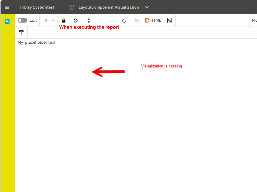

    Executing the report goes wrong
    The console shows that the visualization was executed incompletely.

  • 2.  RE: Cognos 12.1.2: layout component references and visualizations
    Posted 06/08/26 06:14 AM
    Hi Thomas,
    yep: it seems to be a bug. We have already created a ticket @IBM-Support as we see the whole interactive mode to be affected when you use layout component references. E.g. the interactive toolbar on top of the screen disappears when your list/crosstab is placed in a layout reference and custom controls don't work either. So far I couldn't nail it down to the exact circumstances when the issue appears. We're still investigating.

    Posted 06/10/26 01:58 AM
    Hi @Thomas Wolf,
    one thing for clarification: is the issue gone when you open the report in edit mode and run it from this perspective? In our system it is!

  • 8.  RE: Cognos 12.1.2: layout component references and visualizations
    Posted 06/10/26 04:33 AM
    Edited by Lorraine Rizzuto 06/11/26 09:13 AM
    @Robert Dostal: Yes it is.
    Somehow, to me, it looks like a very short timeout setting.
