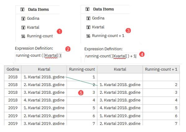

    Make two same queries (1,3). Sort both of them. Create column "running-count" (2) in first query, and "running-count + 1" in the second (4). Join those two queries by "running-count" columns. Then everything will be off by one row (5). Then you can do any calculations you want.
    Offset join between 2 tables
    Milan Milovanovic

    @Milan Milovanovic If there is a need to move a value down a row the moving total technique shown above is far less effort.
    moving-total( [data item],2) - [data item]
