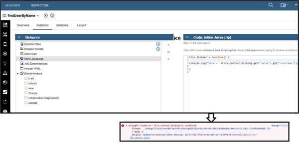

    Good evening community I hope you are well,
    The Error :
    Please I try to get and set data as explained on the images but I always have the following error:  Uncaught TypeError: this.context.binding is undefined
    can someone help me please
    Thx.

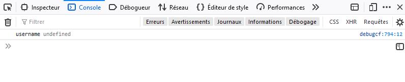

  • 3.  RE: Binding data from view
    Posted 09/20/21 04:25 AM
    Hi Mrs Zafiris
    Thank you for your time, unfortunately it doesn't work I still have undefined

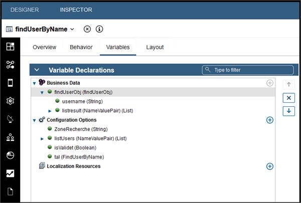

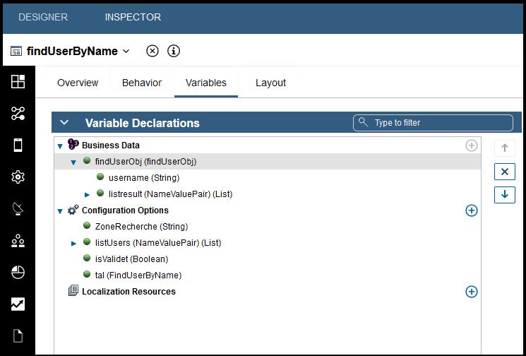

  • 9.  RE: Binding data from view
    Posted 09/20/21 07:15 AM
    Hi Zafiris
    I share with you the variables I have on this view
