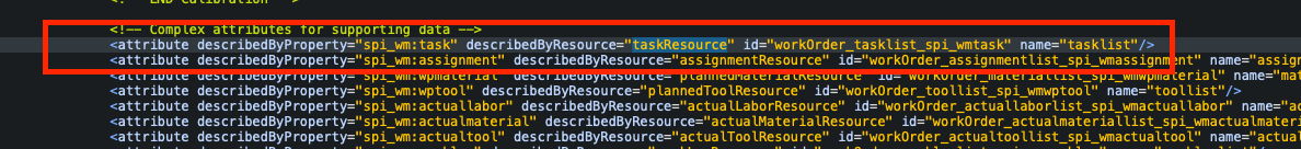

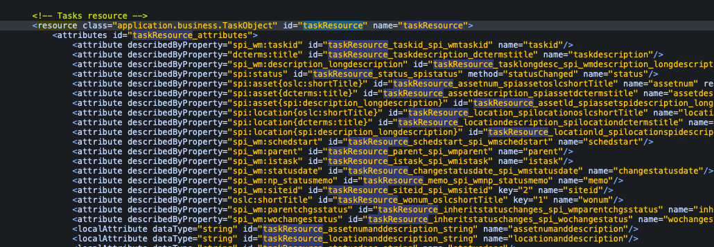

    Did you create the resource in the XML for you "describeByResource"?  If you look at workorder you will see the first complex attribute listed is "taskResource".  If you search on that you will find there is a resource definition that corresponds to the TaskResource. See Below images.  Hope this helps.
    Workorder Resource Complex Attribute for Tasks.
    Task Resource definition
