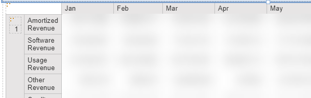

    Looking for some guidance on how to add a line number to a Crosstab report that is sourcing data from Planning Analytics. I have Googled this quite a bit and tried all of the suggestions, but none of them seem to work. What's the trick?

    @Ryan Clapp Try the following:
    1. From the toolbox - drag over a "Crosstab space (with Fact cells)" to the row edge of the crosstab.
    2. Unlock the report
    3. From the toolbox - drag over the object "Row number" and place it inside the Crosstab space added in Step1.
    Let me know if this works for you.

    Thanks, but that does not seem to work. The row number appears inside a table, which is 1 row and therefore only shows #1

    @Ryan Clapp​ The solution provided will work if the row number is nested on the inner row edge. Let me see test and see if I can get a solution for the outer row edge.
    DENNY NAREZNY

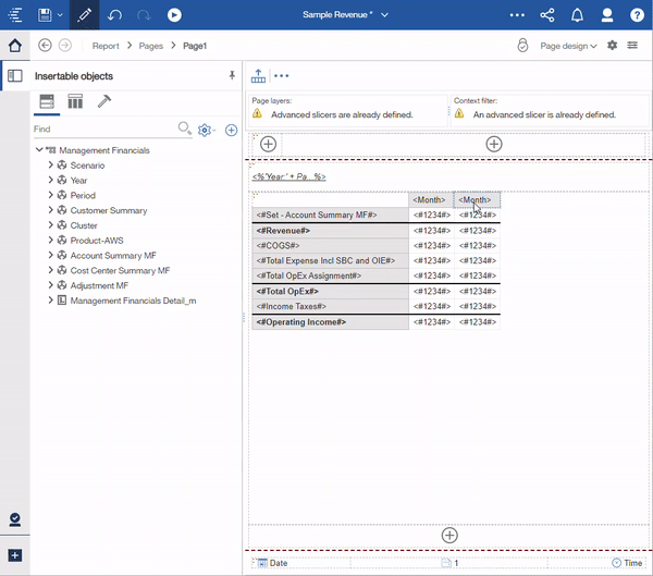

    I tired that and it give me an error:
    With the report locked I get this error:

    It is unlocked as I mentioned in the previous email. Here is a recording:

    Tested a bit more. Dragging and dropping won't work no matter what I tried. If I unlock, click on the row, then double click the row number in the toolbox it worked.
