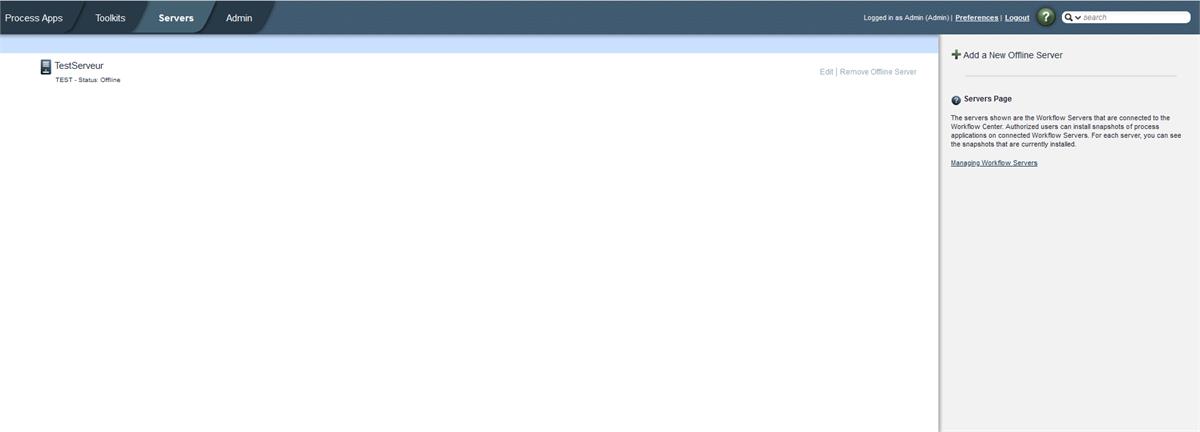

    Hello community ;
    I installed Workflow Server and during the installation I entered the address of the WorkflowCenter correctly but I cannot find the server on WorkflowCenter to do a test deployment.
    I have to do something for the online server to appear on the server list?
    Thank you in advance
    OnlineServer

    You should not need to do any more. In my case the Server appears registered in the Center after installation. Search for exceptions in the logs.
    Alternatively you can add the Server as "Offline Server" and manage the deployment with the AdminTask.BPMInstallPackage command.

    Thank you for your answer I think I had a problem during the installation of the workflow server I will redo the installation to see if it will solve the problem otherwise I will proceed to the second track that you had proposed to me.

    The way a Workflow Server becomes visible in Workflow Center is by sending a regular heartbeat. If the server is not listed then this heartbeat has likely failed (or was not attempted).
    If it failed, you should see something in Workflow Server's SystemOut.log.
    If it there is nothing in the log, it probably wasn't attempted and you can tell Workflow Server what its Workflow Center, see
    https://www.ibm.com/docs/en/baw/20.x?topic=mrscp-customizing-workflow-server-settings-used-connect-workflow-center
    https://www.ibm.com/docs/en/baw/20.x?topic=workflow-connections-from-server-center
