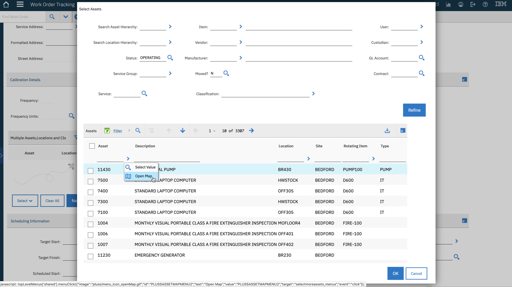

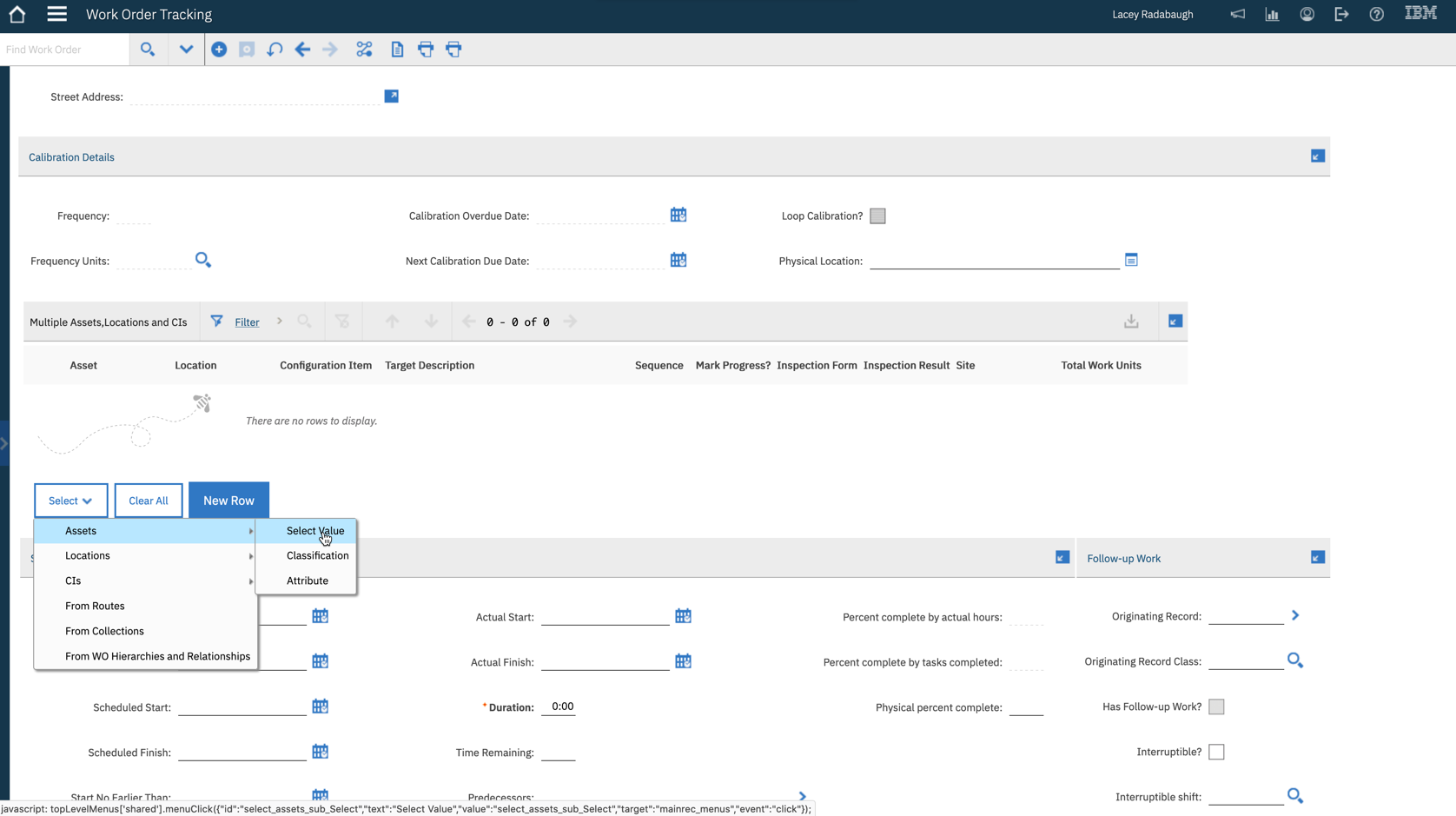

    From the multi-asset section, click on the Select button. Then click on Asset and Select Value.

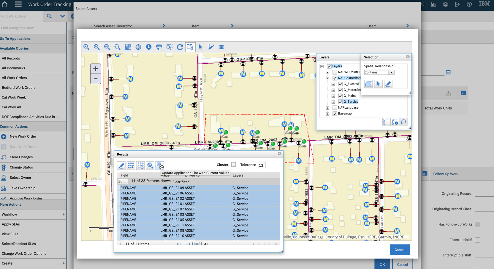

    The Select Asset dialog will be presented. Inside the Asset table, click on the Asset Detail Menu and then Open Map. From the map you can execute the query and send the result back to the dialog by clicking on the tool from the Results tool toolbar. The tool is named Update Application List.

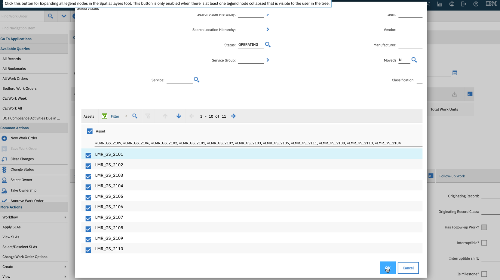

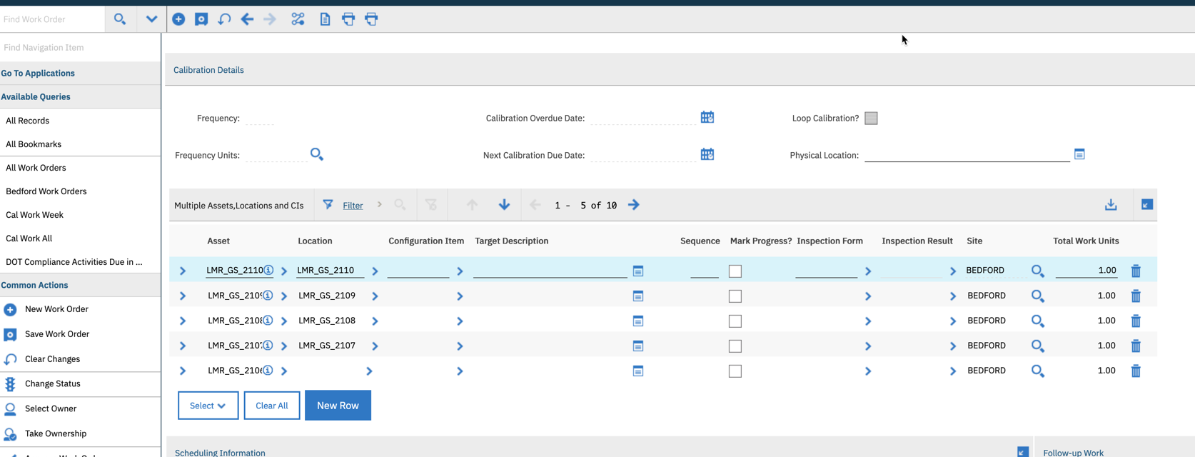

    Here are screenshots to go along with Joao's instructions.
