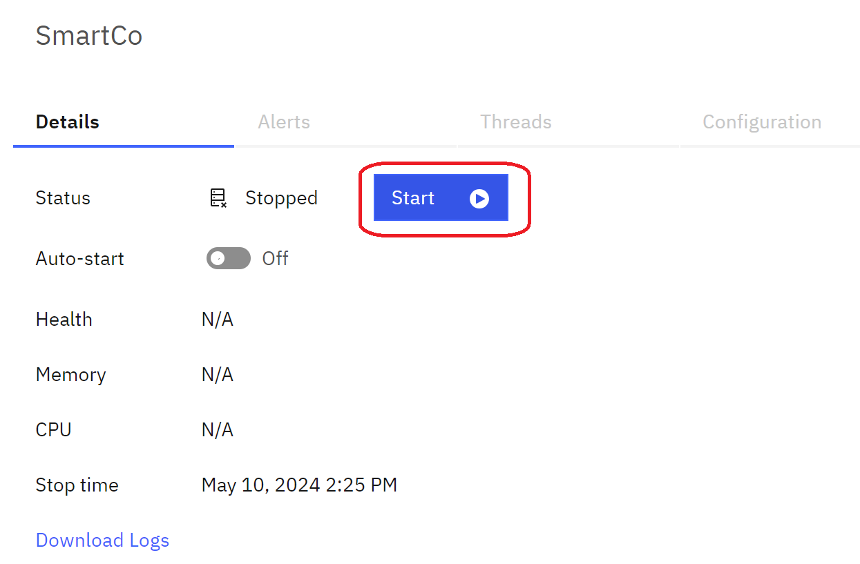

Stop and Start a Database
A database may need to be stopped and restarted when migrating from an existing database or where there are changes to static configuration parameters.
See this link on steps . https://ibm.biz/CS_PAoC_StartStopDB
In Planning Analytics Workspace Administration / Databases , you can tell the status of a database by the Health icon:
    • Stopped:
    • Started / Healthy:
You can also verify by viewing logs with examples of each below. See steps here to download and view logs:
By downloading: https://ibm.biz/CS_PAoC_LogsAdmDownload
In PAW Workbench: https://ibm.biz/CS_PAoC_ViewLogsWorkbench
