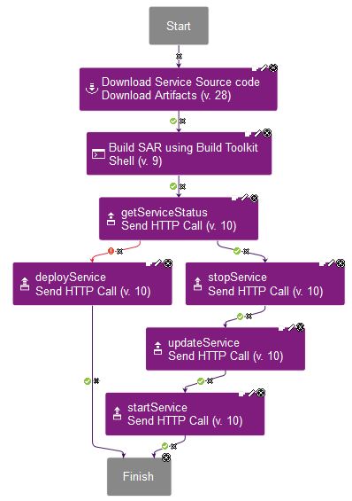

Setting up the UCD process
Our process starts by downloading the source code from the Git repository and then running a script to build the service archive file.
Figure 4. The DevOps process in UCD

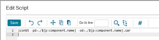

Running the build toolkit
The following figure shows the generation from a project directory that has the same name as the component, and the generated archive file is also set to have the same name.
Figure 5. Running a script to run the build toolkit

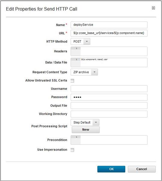

If the service status is neither started or stopped, it means the service does not exist yet. In this case, we’d deploy the service, which is automatically started upon deployment. If the service already exists, we stop the service, update the service, and then start the service.
Figure 7. Deploying a service

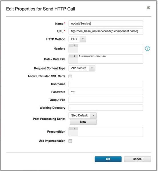

For deploying a new service, we use the POST method. To update a service, we would use a PUT method.
Figure 8. Updating a service
