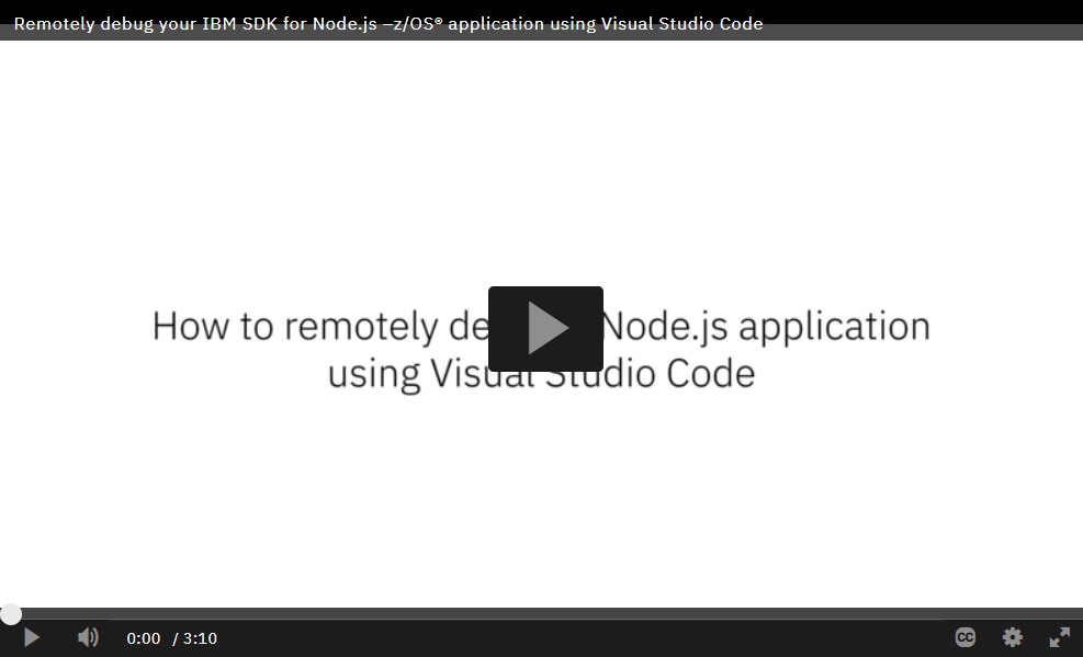

It can sometimes be convenient to remotely debug your Node.js for z/OS application from your local computer. One option is to leverage the --inspect option of Node.js, and connect Visual Studio Code to the Node.js inspector. We have created the following video which will demonstrate how you can do this:
https://mediacenter.ibm.com/media/1_vhcbme46
In the video, we demonstrate how you can debug this simple Node.js application on your z/OS server:
