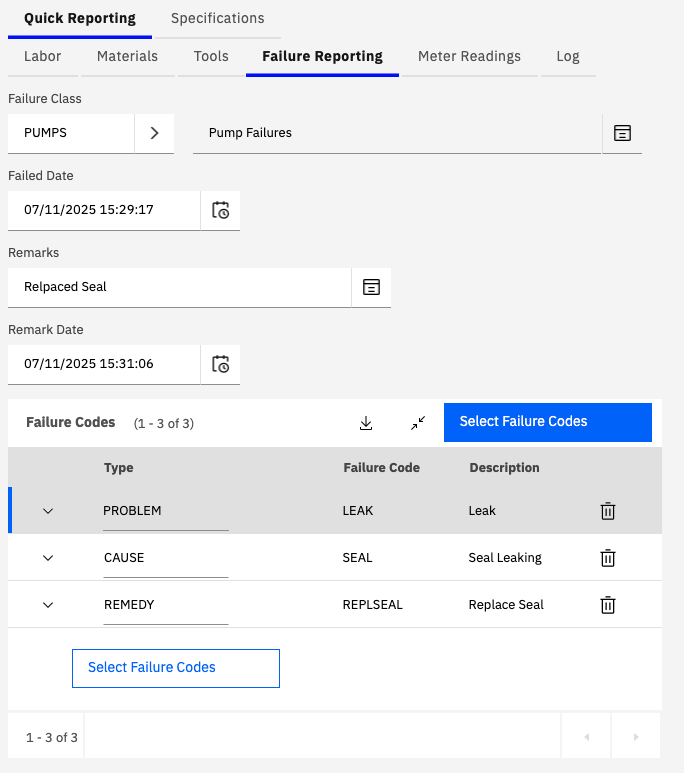

Every CM Work Order in Manage can capture a structured Failure Class with Problem, Cause, and Remedy codes.
Each entry adds a piece to the bigger reliability puzzle.
What used to be a “seal replaced” now becomes:
  • Problem: Seal leakage
  • Cause: Cavitation due to low suction pressure
  • Remedy: Adjust suction valve and review pump NPSH conditions
This simple discipline turns individual fixes into a learning loop.
Over time, Maximo starts to show patterns: pumps with recurring cavitation issues, assets failing after specific process upsets, components with poor MTBF.
