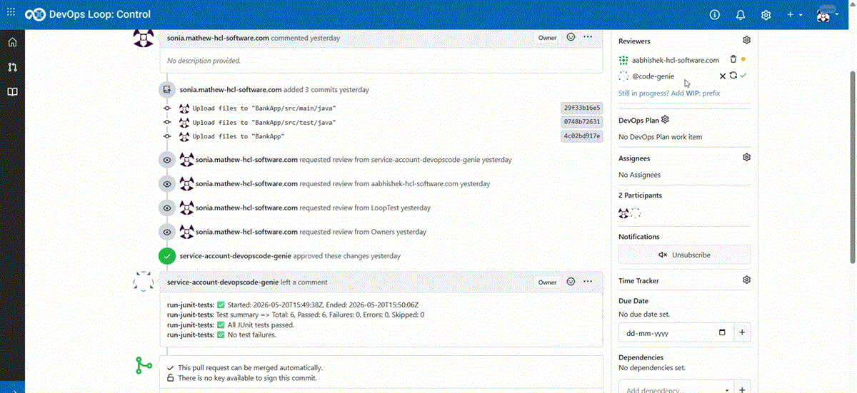

Step 5: Code Genie in Action: Reviewing Your PR
When your code changes are ready, open a Pull Request in Control to merge from the feature branch into the main branch.
The webhook instantly notifies Code Genie. It starts up the lightweight non-IDE container, targets your feature branch code, executes the testing script, and posts a cleanly formatted report directly onto your PR timeline.
Depending on your code quality, there are two possible outcomes:
Case 1: Tests Passing Successfully
The automation runs successfully and captures the execution flow, matching the local test results exactly. Because all indicators are green, Code Genie automatically updates the PR review status to "approved these changes", indicating that it is ready to be merged.
Code Genie automatically approves PR as JUnit tests are successful.
Case 2: Tests Failing
If a bug is introduced into the feature branch that breaks a test, Code Genie acts as a safeguard. It will reject the PR instantly, keeping your main branch functional and secure while instructing you to make the necessary fixes in your feature branch. Failed test results are neatly detailed in a Markdown table directly on the timeline:
