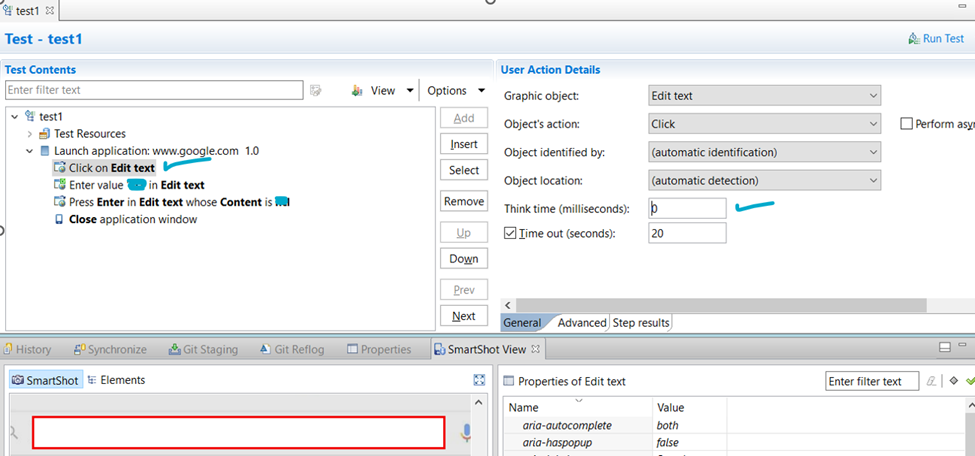

  4. Modify a test step in the Test UI script in DevOps Test UI and save the test script.
    Test step before modification:
    Test step after modification – note that the Think time has been changed to 2000 milliseconds.

  23. The Hard reset will reset the HEAD and modify both the working directory and Index to the specified commit state. Open the Web UI test and observe that the test step Click on Edit text shows the think time as 0 instead of 2000 milliseconds, which means that the script is reverted to the specific commit state.
