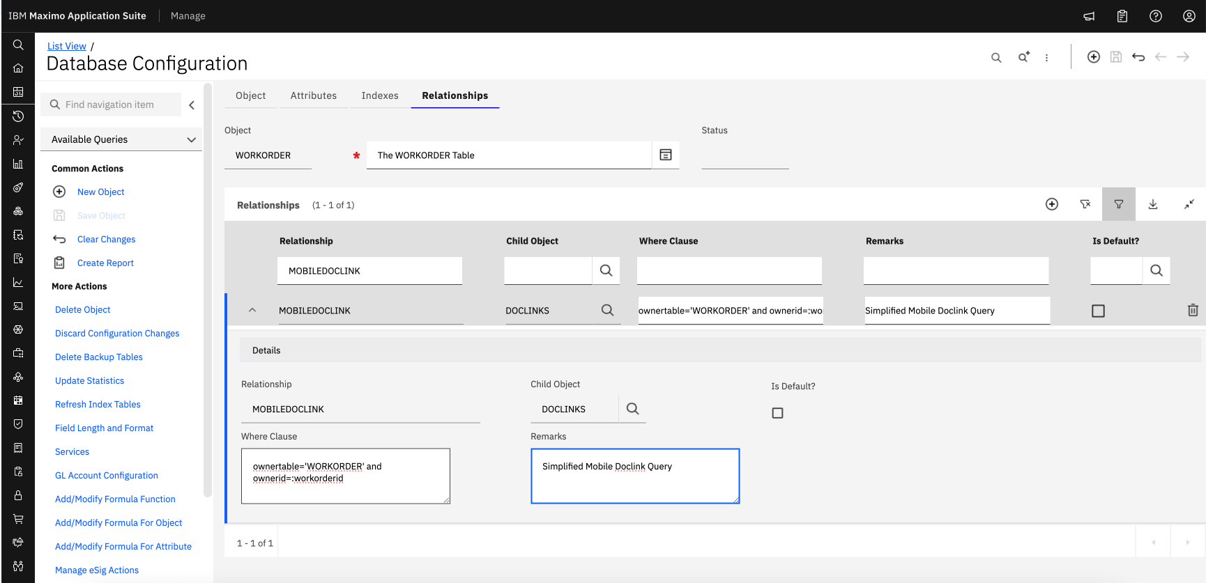

Step 1: In this step, we will create a new relationship that downloads only the workorder's doclinks and attachments on mobile
1. Go to the database configuration application
2. Search for WORKORDER and select it
3. Go to relationships
4. Create a new relationship
5. Name it MOBILEDOCLINK
6. Select DOCLINKS for Child Object field
7. Set the where clause to
ownertable='WORKORDER' and ownerid=:workorderid
This includes only the workorder’s attachment. You can alter this query (Where clause) to add more objects based on usage. Here is an example of how we can add attachment data for Assets in the same query.
doclinksid in (select doclinksid from doclinks where (ownertable='WORKORDER' and ownerid=:workorderid) UNION ALL select doclinksid from doclinks where (ownertable='ASSET' and ownerid in (select assetuid from asset where assetnum=:assetnum and siteid=:siteid)))
Adding here the Out of the Box doclink relationship to refer to build your custom query. Remove the UNION ALL section for the object you don't want its attachment to download on mobile.
doclinksid in (select doclinksid from doclinks where (ownertable='WORKORDER' and ownerid=:workorderid) UNION ALL select doclinksid from doclinks where (ownertable='WORKORDER' and ownerid in (select workorderid from workorder where parent=:wonum and istask=1 and siteid=:siteid)) UNION ALL select doclinksid from doclinks where (ownertable='ASSET' and ownerid in (select assetuid from asset where assetnum=:assetnum and siteid=:siteid)) UNION ALL select doclinksid from doclinks where (ownertable='LOCATIONS' and ownerid in (select locationsid from locations where location=:location and siteid=:siteid)) UNION ALL select doclinksid from doclinks where (ownertable='JOBPLAN' and ownerid in (select jobplanid from jobplan where jpnum=:jpnum and (siteid is null or siteid=:siteid) and pluscrevnum =:pluscjprevnum) ) UNION ALL select doclinksid from doclinks where (ownertable='PM' and ownerid in (select pmuid from pm where pmnum=:pmnum and siteid=:siteid)) UNION ALL select doclinksid from doclinks where (ownertable='SAFETYPLAN' and ownerid in (select safetyplanuid from safetyplan,wosafetyplan where safetyplan.safetyplanid=wosafetyplan.safetyplanid and wosafetyplan.wonum=:wonum and wosafetyplan.siteid=:siteid)) UNION ALL select doclinksid from doclinks where (ownertable in ('SR','INCIDENT','PROBLEM') and ownerid in (select ticketuid from ticket,relatedrecord where ticketid=recordkey and ticket.class = relatedrecord.class and relatedrecclass=:woclass and relatedreckey=:wonum and relatedrecsiteid=:siteid)) UNION ALL select doclinksid from doclinks where (ownertable in ('WOCHANGE','WORELEASE','WOACTIVITY') and ownerid in (select workorderid from workorder,relatedrecord where wonum=recordkey and workorder.woclass = relatedrecord.class and relatedrecclass=:woclass and relatedreckey=:wonum and relatedrecsiteid=:siteid)) UNION ALL select doclinksid from doclinks where (ownertable='COMMLOG' and ownerid in (select commloguid from commlog where ownerid=:workorderid and ownertable in (:&synonymlist&_WOCLASS[ACTIVITY,CHANGE,RELEASE,WORKORDER]))) UNION ALL select doclinksid from doclinks where (ownertable='SLA' and ownerid in (select slaid from sla,slarecords,workorder where sla.slanum=slarecords.slanum and slarecords.ownerid=workorder.workorderid and sla.objectname='WORKORDER' and slarecords.ownertable='WORKORDER' and workorder.wonum=:wonum)) UNION ALL select doclinksid from doclinks where (ownertable='PLUSDSPLAN' and ownerid in (select plusdsplanid from plusdsplan where (siteid is null or siteid=:siteid) and status in (select value from synonymdomain where (siteid is null or siteid=:siteid) and domainid = 'PLUSCDSSTATUS' and maxvalue = 'APPR') and dsplannum in (select dsplannum from pluscwods where wonum=:wonum and siteid=:siteid))))
