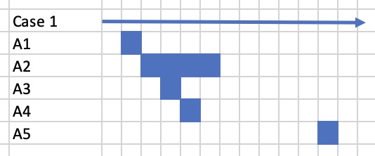

Let's start with a simple case (case 1).
- A1 starts the case
- A2 starts after A1, and includes an end-date (service time = 5 min)
- A3 and A4 start 1 minute after A2, with no end-date.
- A5 starts 10 min after A1.
In this case, A3 and A4 are executed in parallel with A2.
Load this event log: Parallelism-case1.csv to see how parallelism is displayed in Process Mining.

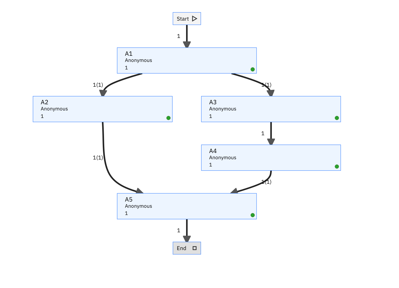

A3 and A4 start after A2, but occur during A2. Therefore they are indicated as parallel activities with a transition from A1.
  • 1(1) on A1->A2 says that there is one occurence with 1 parallelism. Same for 1(1) on A1>A3
  • A4 follows A3, therefore there is a simple A3->A4 transition.
  • Then the parallelism merges into A5. This is shown with 1(1) on the transitionS A2->A5 and A4->A5
You should see this process model:
As expected, the generated BPMN model shows the parallelism with the 2 AND gateways:

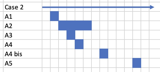

Let's now add a second case that contains a new activity A4-bis that starts after A2 completes. Case 2 looks like this:
Load this event log: Parallelism-case2.csv

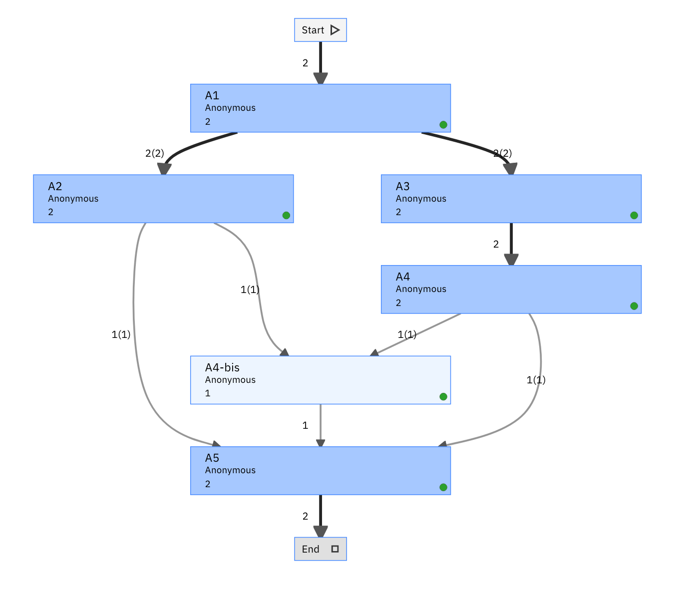

We now see 2(2) on A1-A2 and on A1-A3 because we have 2 cases with parallelism in each.
As expected, one parallelism merges in A5 (case 1), and the other one merges in A4-bis (case 2).
This is shown with 1(1) on A2-A5 // A4-A5 for case 1; and with 1(1) on A2-A4bis // A4-A4bis

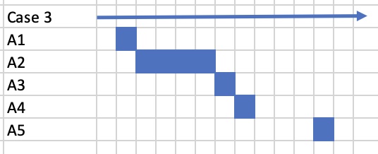

Case 3 looks like case 1, but A3 and A4 start after A2 terminates.

  • We have 1 transition on A2-A3 for case 3.
  • 2(1) on A4->A5 says that we have 2 transitions and 1 parallelism (case 1). The direct transition is for case 3.
