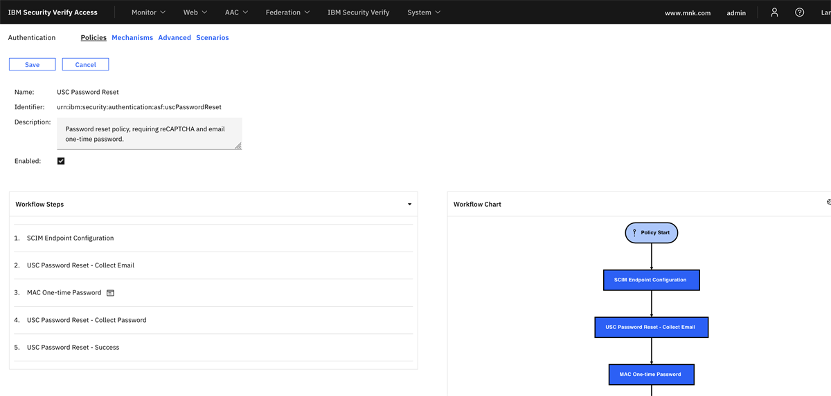

Enable the USC Password Reset policy
- Go to AAC -→ Authentication -→ USC Password Reset -→ select the enable checkbox and save.

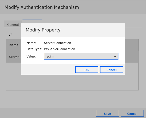

- Modify the SCIM Endpoint Configuration mechanism to point the SCIM
- Go to AAC -→ Authentication -→ Mechanisms -→ Search for SCIM Endpoint Configuration -→ Select and click on edit option
- Go to properties -→ Click Server Configuration -→ Select SCIM option -→ Click ok and save

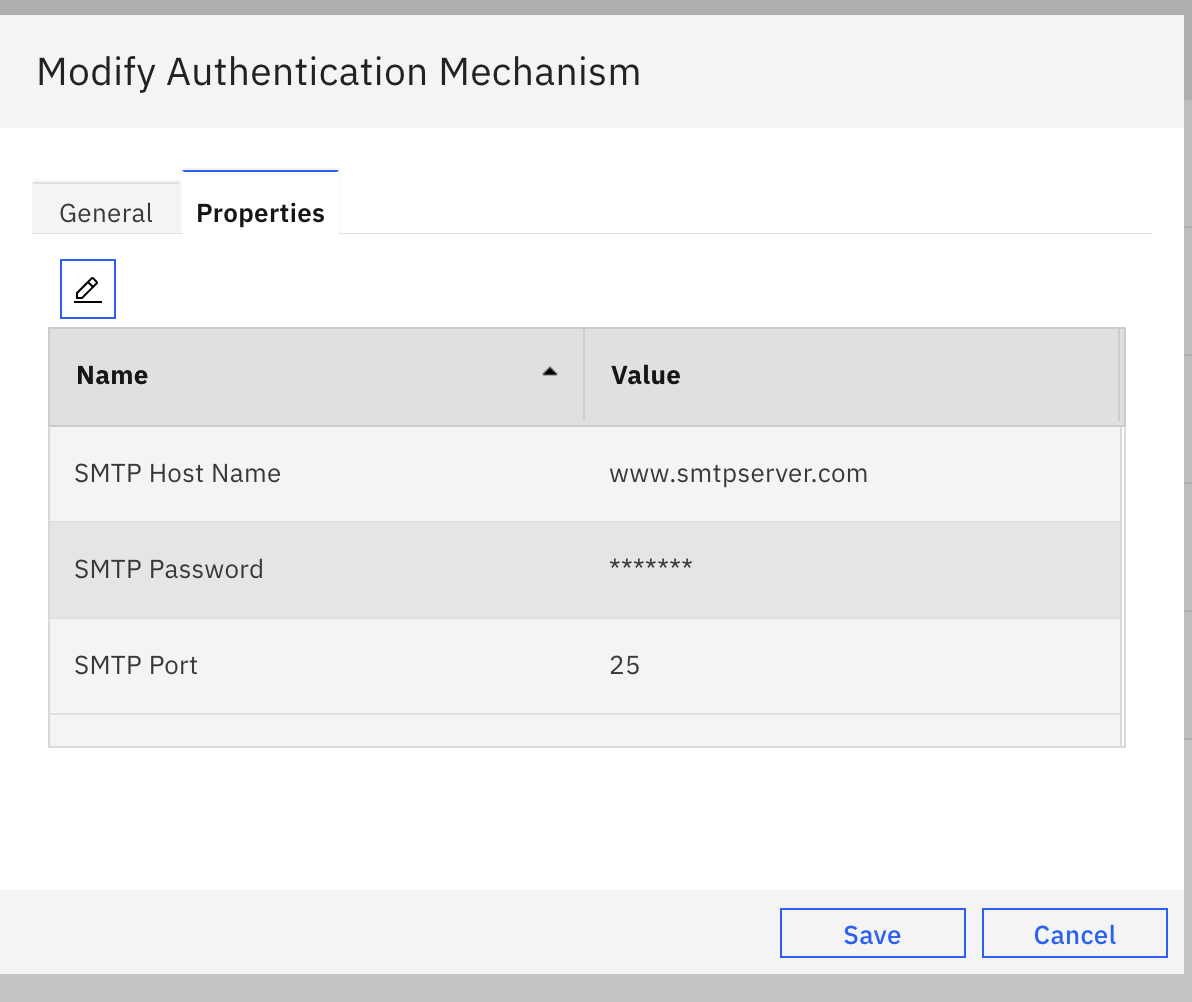

- Add the SMTP server details which will be used to send the OTP via emails
- Go to AACA -→ Authentication -→ Mechanisms -→ Search for Email One-time Password -→ edit -→ go to properties and following details. You could get this details from your SMTP server
Add SMTP Host Name, SMTP Host Name, SMTP Password, SMTP Port, SMTP User Name, Sender Email, and modify if only if you are using ssl connection with SMTP server.

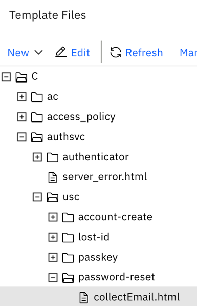

- Modify collectEmail.html.
Go to AAC -→ Template files -→ collectEmail.html
- Before:
<BUTTON TYPE="submit" ID="submitButton" DISABLED>Submit</BUTTON>
After:
<BUTTON TYPE="submit" ID="submitButton" >Submit</BUTTON>

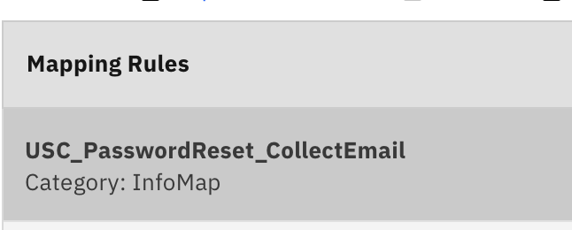

- Modify the Mapping Rule.
- Go to AAC -→ Mapping Rules -→ Search for USC_PasswordReset_CollectEmail
- Add the code snippet which is in between Start and Finish block,

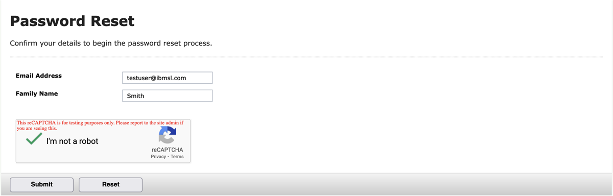

- Lets test the normal flow when user is not disabled.
Hit the policy URL -→ https://<Reverse_Proxy_IP>/mga/sps/authsvc?PolicyId=urn:ibm:security:authentication:asf:uscPasswordReset
Add the email address and Surname, Submit

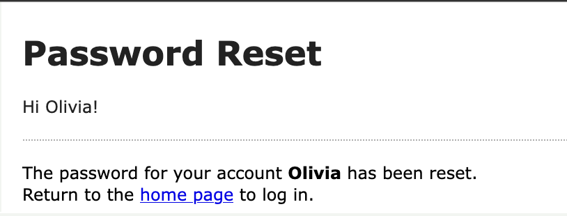

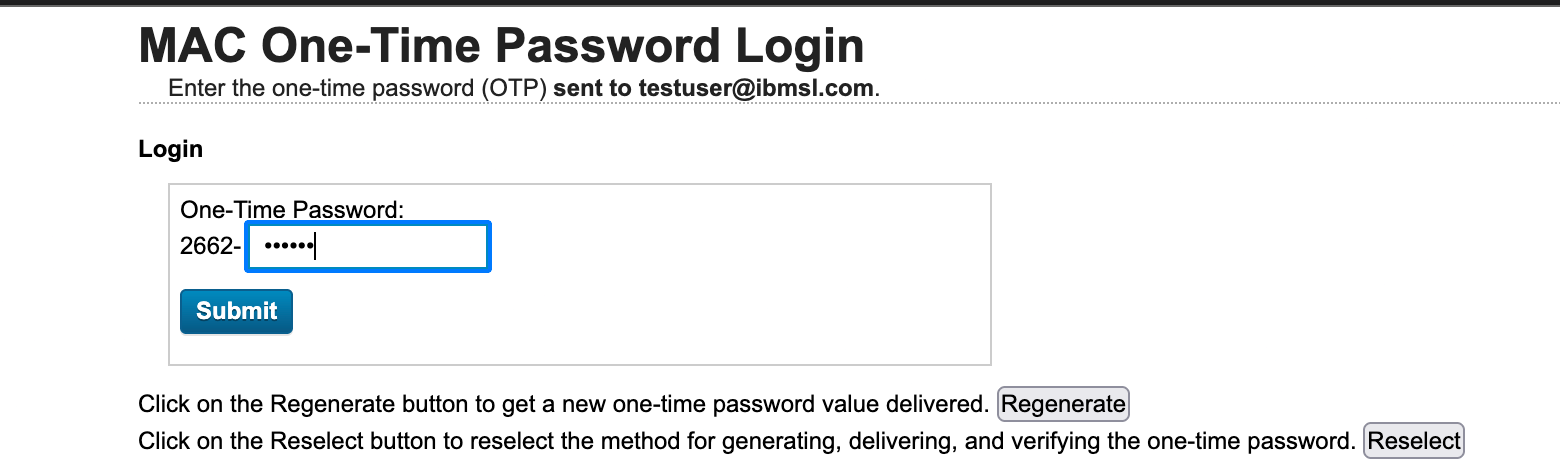

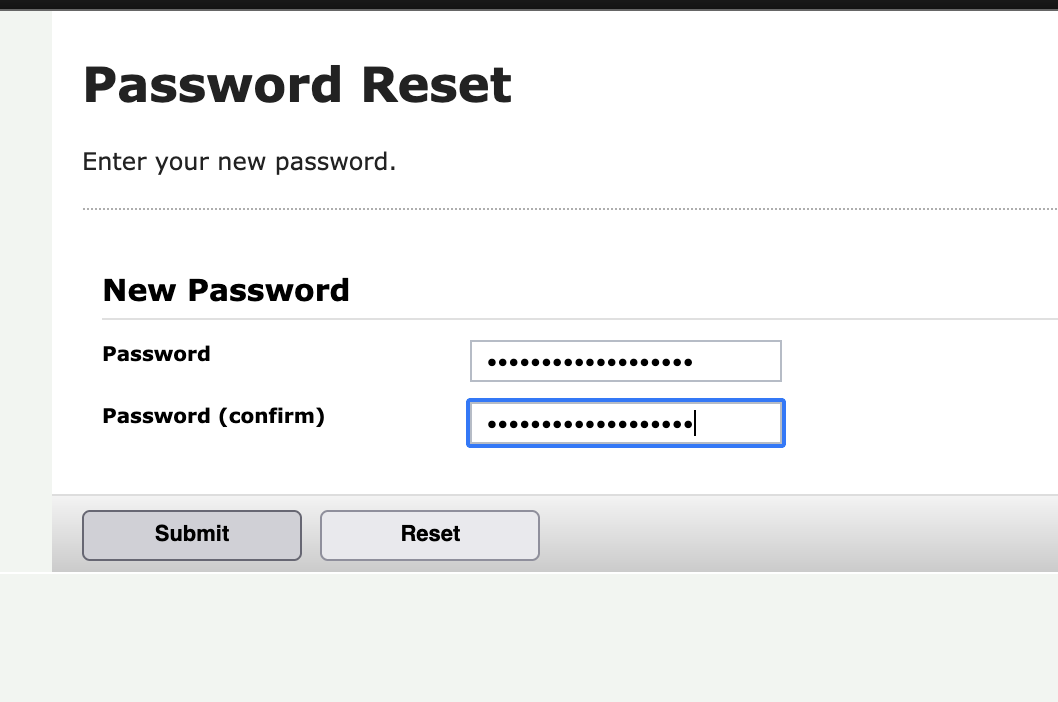

- Type OTP received on the email address
Type new password ( Make sure it fulfills the password policy criteria )
- And password got reset.

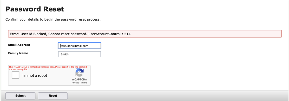

- Now test it by Disabling the user from AD.
- 'Hit the URL -→ https://<Reverse_Proxy_IP>/mga/sps/authsvc?PolicyId=urn:ibm:security:authentication:asf:uscPasswordReset
- Add the email address of user and its surname and click submit, Now it will block the further execution and will show error.
- In this way you can prevent the reset of password when your account is disabled on AD using IVIA USC Password Reset Utility.
