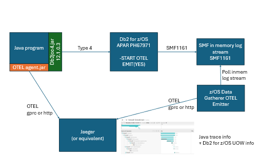

In the architecture diagram below you can see that there are multiple components in play:
•    Java program
•    Db2 for z/OS
•    SMF
•    z/OS Data Gatherer - OTEL emitter
•    Observability platform (e.g., IBM Instana, Jaeger, or Grafana)
The emphasis on this blog will be on the Java program, but we will briefly cover the other components first.

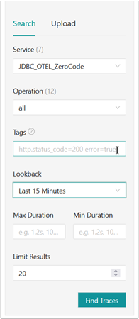

Observability platform: Jaeger
In this blog we've used Jaeger as the observability platform, but there are many other options available including IBM Instana and Grafana.
The easiest way to get started is to simply run Jaeger in a container as documented here: https://www.jaegertracing.io/docs/2.12/getting-started/#all-in-one

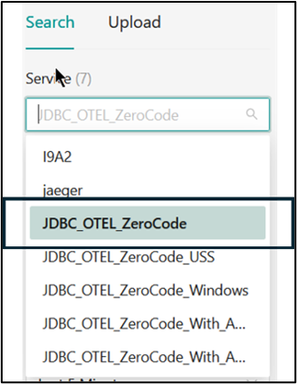

OTEL_SERVICE_NAME=JDBC_OTEL_ZeroCode
Choose a meaningful name which helps to locate the service requests in your observability backend.

Now it’s time to check in your observability backend whether you can find the Db2 trace records and whether you can correlate them to your Java program. We used Jaeger for our testing.
In the Jaeger search window, you should see the service name which you provided in the OTEL_SERVICE_NAME  environment variable under the “Service” drop down.
In the “Lookback” drop down choose a value that includes the time when you ran your test program, e.g. the last 15 minutes.

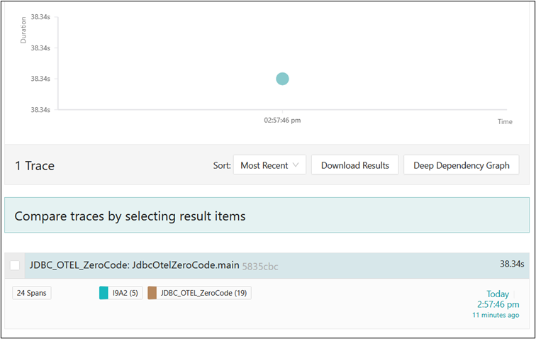

You should see at least one entry on the right-hand side of the window which represents the execution of your instrumented JDBC program:
As you can see in this example, a total of 24 span records has been captured by OTEL for this program execution. 19 of 24 spans have been written by the Java program itself and another 5 by Db2.
You can click on the field that contains the total number of spans (“24 Spans” in this example) to get a visual representation of the spans.

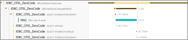

Without going too much into the details, you can get an impression of how OTEL instrumentation can help you to trace the flow of an application across multiple platforms. In this simple example, a JDBC application under z/OS USS executing Db2 for z/OS SQL statements via JDBC T4.
Every bar in this graph represents one span for which OTEL has captured execution times and other metrics. Most of the spans are generated in your JDBC application (by the Java agent), the rest of the spans (in blue color in this example) by Db2.
As you could see, no code change has been made to your Java program. Zero-code instrumentation should be your first step, when you want to start your OTEL journey for Db2 for z/OS, however you need to consider some important things:
Db2 creates a span for every unit of work. Every Db2 span contains some environmental information (such as correlation ID, plan name, LUWID) plus basic metrics: class 2 elapsed, CPU, and zIIP time. Since a Db2 unit of work can contain multiple SQL statements, these spans generated by Db2 do not necessarily provide metrics for a single SQL statement execution.
Zero-code instrumentation injects your Java code at certain places. For example, when your Java code executes a JDBC call it creates a new span for every single JDBC execute call of your Java application. However, the Db2 span is created as child span for the first JDBC call in the Db2 unit of work.

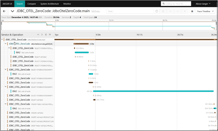

Example:
The JDBC application issues 4 SQL statements in one unit of work and a COMMIT at the end.
•    SELECT … FROM SYSIBM.SYSDUMMY1
•    WITH X AS (SELECT ….)
•    SELECT … FROM SYSIBM.SYSTABLES
In Jaeger, the sequence of spans looks like this:
The first span in this graph represents the main method of your Java program (covering the entire program execution). The second span represents the method “getDBInfo” in the program, containing some JDBC calls. As a child of this span, the third span, annotated with “SELECT SYSIBM.SYSDUMMY1” is generated when the “execute” method is called. The span for the Db2 unit work, generated by Db2 for z/OS OTel service, is shown as child of this previous JDBC span. However, from a Db2 perspective, it covers not just this SQL statement but also the following three statements until a COMMIT is reached. From the observability backend, you may think that this Db2 unit of work covers the first SQL statement only, which is not the case. As you can see, the span for the 4th SQL statement (SELECT SYSIBM.SYSDUMMY1) ends shortly after the Db2 unit of work finishes.
Zero-code instrumentation is not aware of the fact that the Db2 unit of work contains multiple SQL statements, so one span is created for every SQL statement.
In case this level of granularity is not required, JDBC-related method invocation can be excluded from instrumentation. This requires an additional environment variable setting:
OTEL_INSTRUMENTATION_JDBC_ENABLED=false
With this setting, Db2 will still create a span for every unit of work, but no spans would be created for every single client JDBC call:

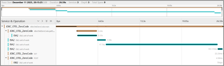

As you can also see in these examples, you can also instrument calls to Db2 native REST services. Every REST call is a Db2 unit of work and, with Zero-code instrumentation, the OTEL framework will create spans for the calling GET and POST methods as well.
Also, there are no specific considerations for Db2 units of work which contain stored procedure executions (with the exception of autonomous stored procedures). Their executions would be part of a Db2 span like other SQL executions.
