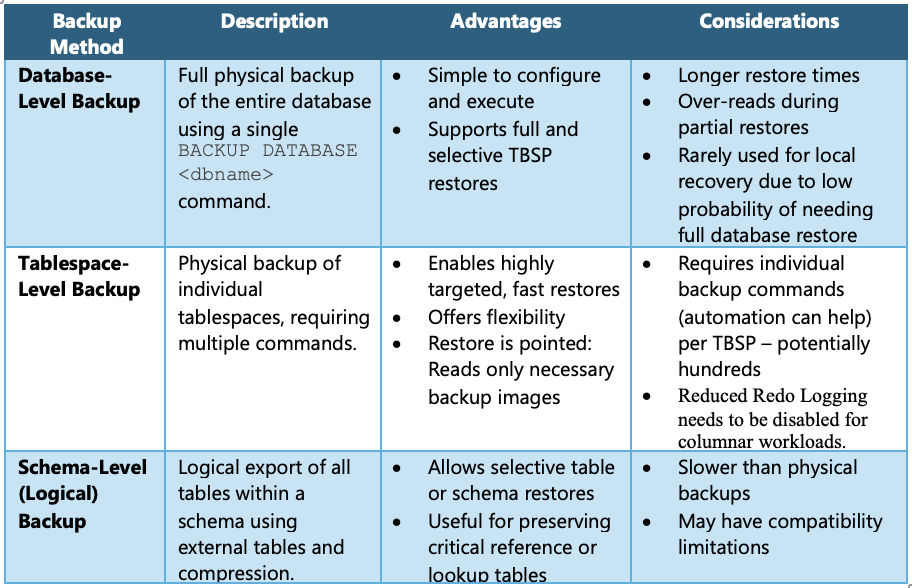

In IBM’s P10 PCR Db2 Warehouse environments, three primary backup methods are available: full-database backups, tablespace-level backups, and schema-level (logical) exports. Each method offers distinct advantages and trade-offs in terms of simplicity, precision, and performance.
Backup Methods
In practice, a hybrid approach often delivers the best results—combining weekly full-database backups, daily incremental or tablespace-level backups, and periodic schema exports. This strategy balances simplicity, precision, and performance.

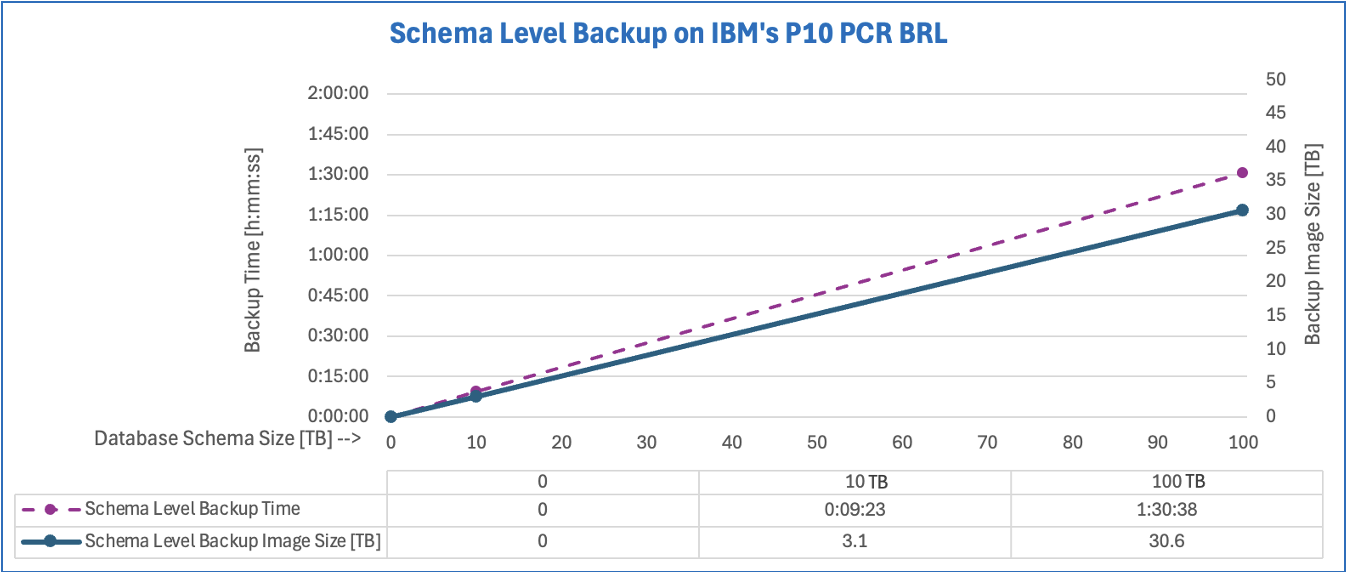

4.1 Schema Level Backup
The schema level backup is done via the following stored procedure call and was tested with both a 10TB BDI schema and 100TB BDI schema to determine if backup time and resulting backup image size scale linearly. The backup image is stored on the local disk.
db2 -v "call sysproc.logical_backup('-type full -schema ${schema} -path /mnt/backup/DBBackup/${schema}')"
Results:
The following graph shows that the schema level backup time and image size scale linearly from 9min 23 sec for the 10TB setup to 1h 30min and 30.6TB for the 100TB Setup.
Schema Level Backup

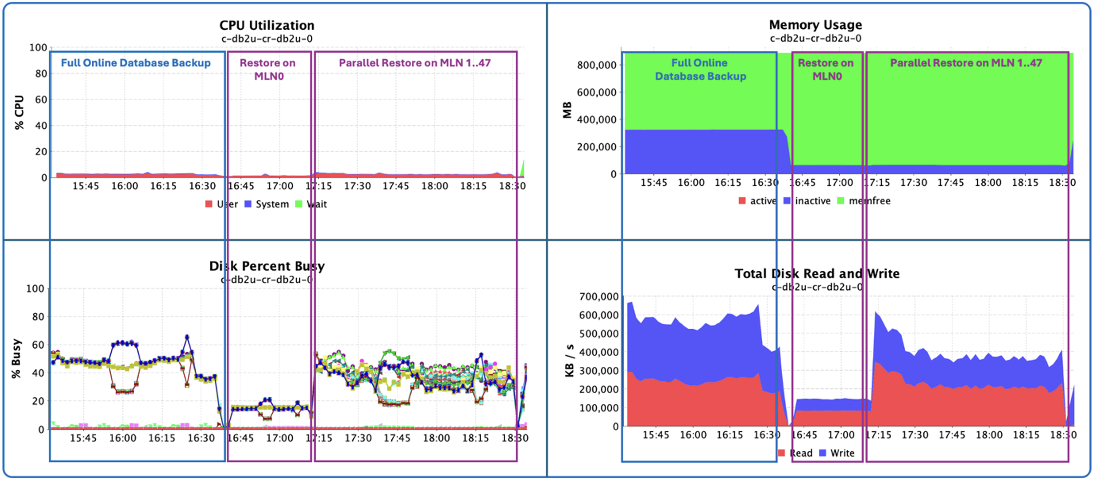

4.4 System Utilization during Backup & Restore
The following NMON Visualization graphs show the system utilization on the Power PCR BRL system during the full online database backup and subsequent restore operation. The system is healthy with disk utilization averaging around 50-60% and very low CPU utilization of under 5%.
System Utilization Backup & Restore
