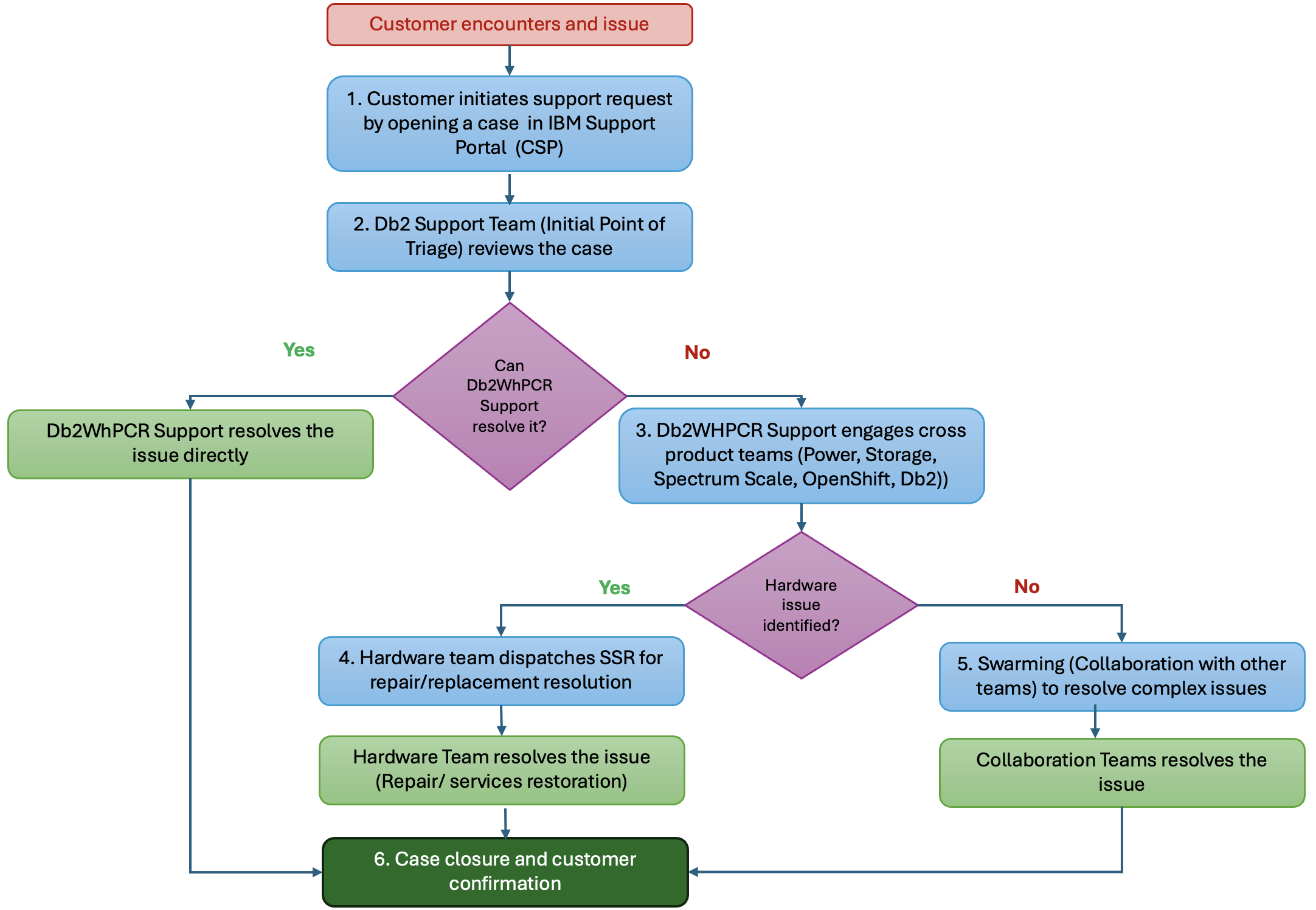

The following flowchart illustrates the user experience when using the Advanced Support option for Db2 Warehouse on Power Cloud Rack – from the moment an issue is identified to its resolution.
Figure 1: Flowchart: Navigating Support for Db2 Warehouse on Power Cloud Rack
Next, we will take a closer look at each step in the process to provide deeper insight and guidance.

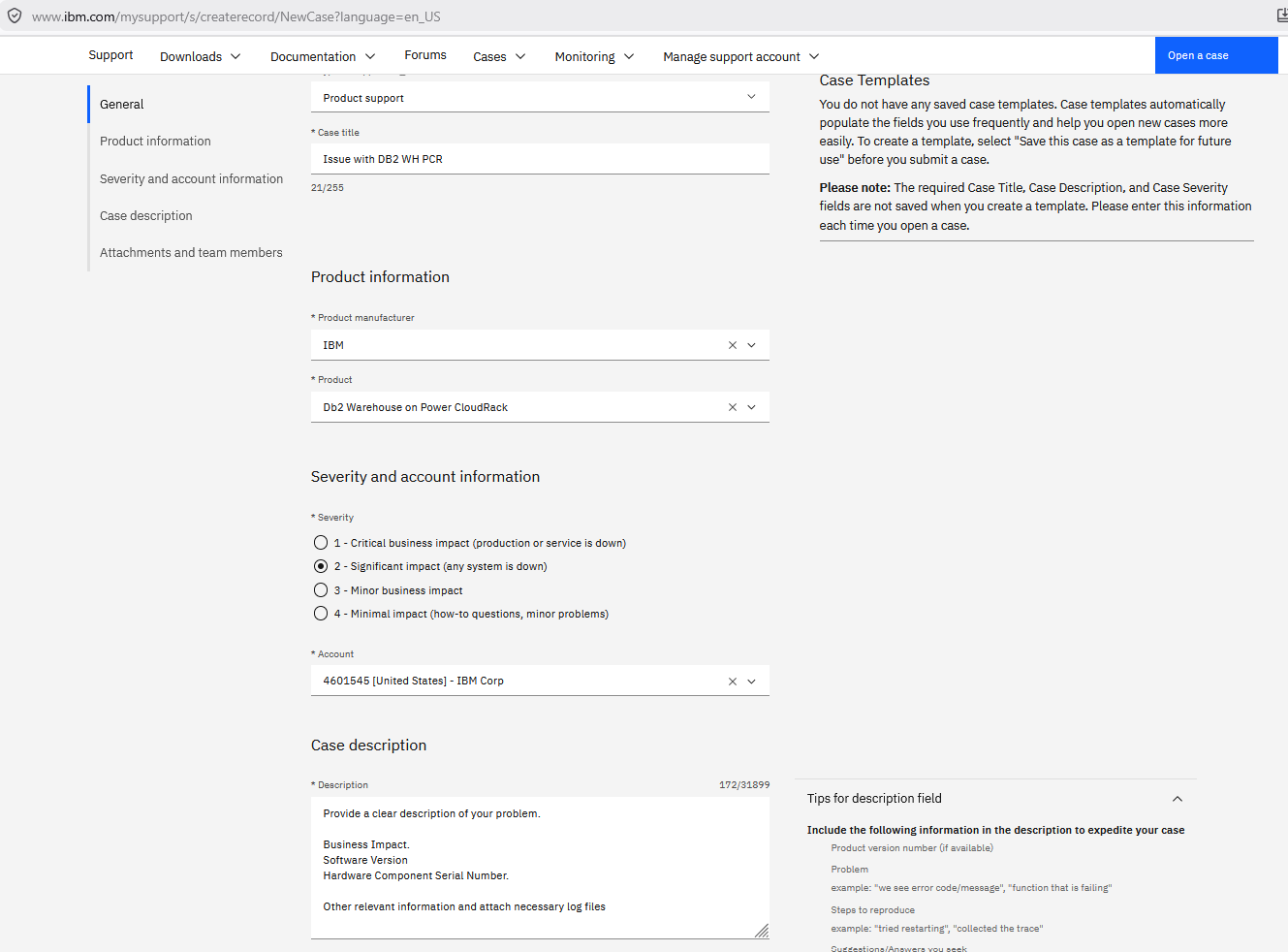

Step #1: Customer Initiates the Support Request
The support process begins when a customer initiates a support request by opening a ticket through the Customer Support Portal (CSP). To do so, navigate to the portal and click on "Open a Case." When completing the form, be sure to select "Db2 Warehouse on Power Cloud Rack" as the product and provide all relevant details, including the case severity, a clear description of the issue, and any additional necessary information. Supplying comprehensive information at the outset helps expedite the support process and ensures that the case is routed appropriately. The image below displays a sample case template as it appears when a ticket is submitted through the Customer Support Portal (CSP).
Figure 2: Case Template for opening a new support ticket through the CSP

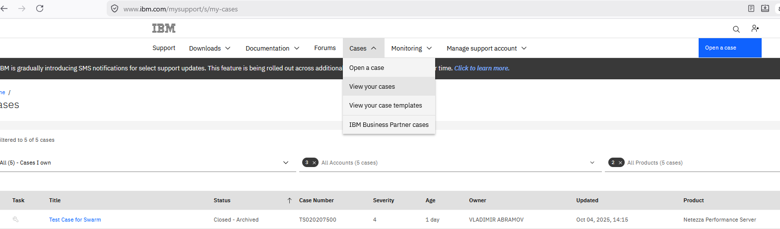

To follow up on an existing case, navigate to the “View My Cases” section and select the relevant case from your list. If there is an ongoing case that requires additional information, providing updates within the existing case ensures continuity and helps the IBM Support team resolve the issue more efficiently.
Figure 3: Following up on an existing support ticket through the CSP
Best Practices for Opening a Support Ticket
Submitting a well‑structured support ticket helps us diagnose issues faster and resolve them more effectively. Please follow the guidelines below when opening a case.
1. Write a Clear and Effective Problem Title
                  • Summarize the issue in one concise sentence
                  • Include the product/component, symptom, and impact where possible
                  • Avoid vague titles like “System not working”
2. Provide a Detailed Problem Description
Include enough context so the support team can understand the issue without follow‑up:
           • What you were trying to do when the problem occurred
           • What you expected to happen vs. what actually happened
           • When the issue started and whether it is intermittent or reproducible
           • Any recent changes (upgrades, configuration changes, patches, environment changes)
           • Scope of impact (single user, multiple users, all users, production vs. non‑production)
Clear, structured descriptions significantly reduce resolution time.

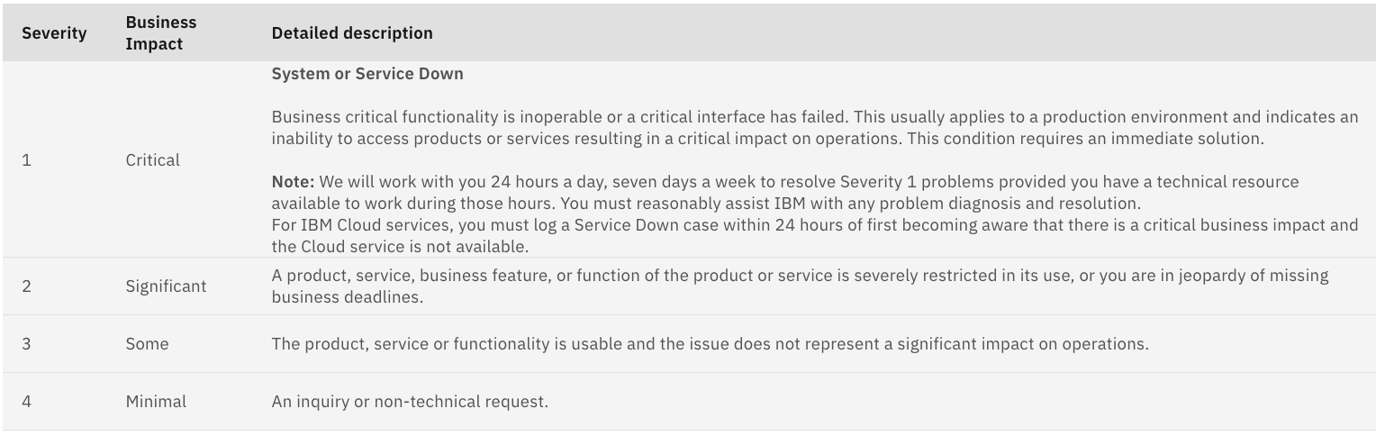

3. Select the Correct Severity Level
Choose the severity that best reflects business impact, not urgency alone. Please use the severity definitions outlined here to select the appropriate severity level for your case.
Figure 4: IBM Enterprise Support Severity Definitions

Step #2: Initial Point of Triage (IPOT): Db2WhPCR Support Team
In Step 2, the Db2WhPCR team serves as the Initial Point of Triage (IPOT) for all tickets related to the Db2 Warehouse Solution Stack. Upon receiving a support ticket, the Db2WhPCR Team evaluates the issue and determines the appropriate next steps. Depending on the nature of the problem, they may either resolve the issue directly within the Db2WhPCR support scope or engage additional specialized teams—such as Power, or Storage —as needed to ensure a complete and efficient resolution. Please note if call-home capability is enabled, hardware related cases are directly opened with respective teams (Power, Storage) and those teams will be engaged on appropriate resolution.
Step #3: Engaging Cross Product Teams
In Step 3, if an issue requires support for Power, Storage, or other software components, IBM Db2WhPCR Support Team will engage the appropriate teams (via Internal Skills Case). The respective Support Missions will be brought in as needed to address specific aspects of the issue. All IBM Support teams operate under established Business As Usual (BAU) procedures, ensuring a consistent and coordinated approach to problem resolution across all involved groups.
Step #4: Handling of Hardware Issues
In Step 4, if the investigation determines that hardware repair or component replacement is required, the Hardware Support Team will dispatch a Service Support Representative (SSR) with the necessary parts to complete the repair. Appropriate support teams will also be engaged to ensure a smooth repair process and the prompt resumption of Db2WhPCR services. To further streamline support, IBM highly recommends enabling the call-home capability via the Hardware Management Console (HMC). When call-home is activated, an automatic support case is created, allowing IBM Support to proactively manage hardware-related issues. Call-home cases will automatically route to their respective Hardware Support missions. For guidance on enabling the call-home feature, please follow the instructions here.
Step #5: Coordination for Complex Issues
In Step 5, when complex, multidisciplinary issues arise that require collaboration across teams—such as Db2, Power, and Storage—the Db2WhPCR Support Team will manage the overall coordination. The Db2WhPCR team will engage the necessary groups by opening Skills Cases as needed, facilitating communication and collaboration among the involved support and development teams. The primary goal is to ensure seamless teamwork and efficient resolution of complex issues, minimizing disruption to user operations.
Step #6: Case Monitoring and Closure
In Step 6, the Db2WhPCR continues to monitor progress across all engaged teams to ensure timely resolution and case closure. This approach aligns with the support model used across other IBM products, providing users with a familiar and streamlined experience that simplifies issue management and accelerates time-to-value.
