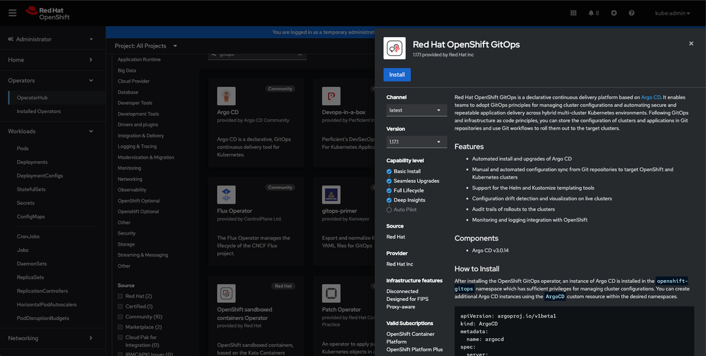

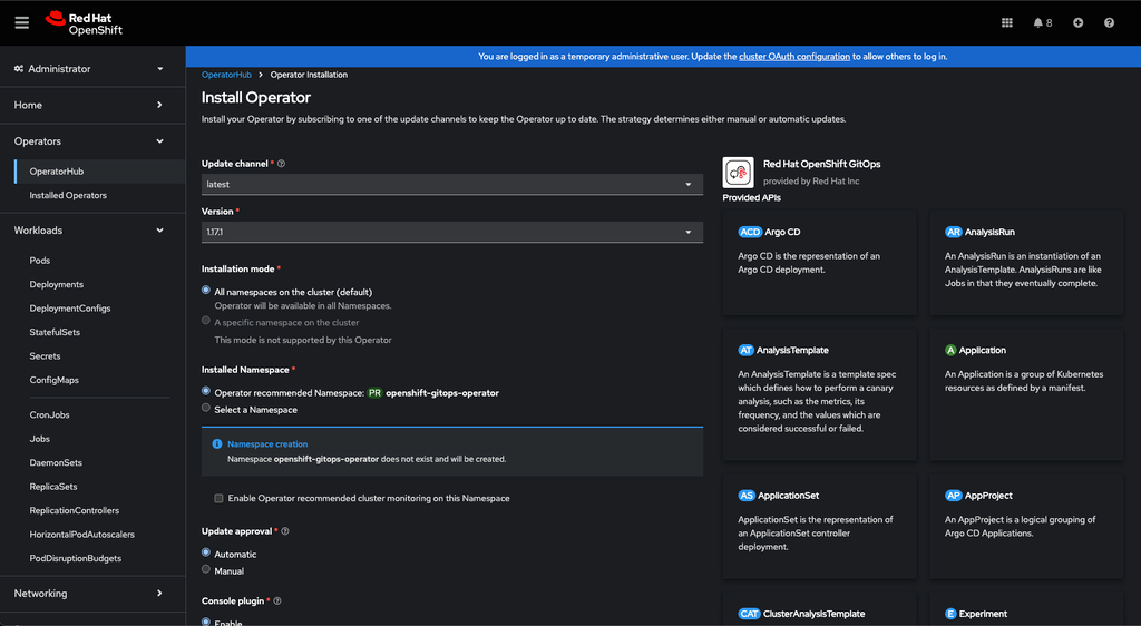

    To get started, install the Argo CD operator from OperatorHub. By default, this installs OpenShift GitOps into the `openshift-gitops` namespace, and for the purposes of this walkthrough, enable cluster monitoring on the desired namespace:

    Once the operator is up and running, you’ll have an Argo CD instance ready to manage GitOps workflows.

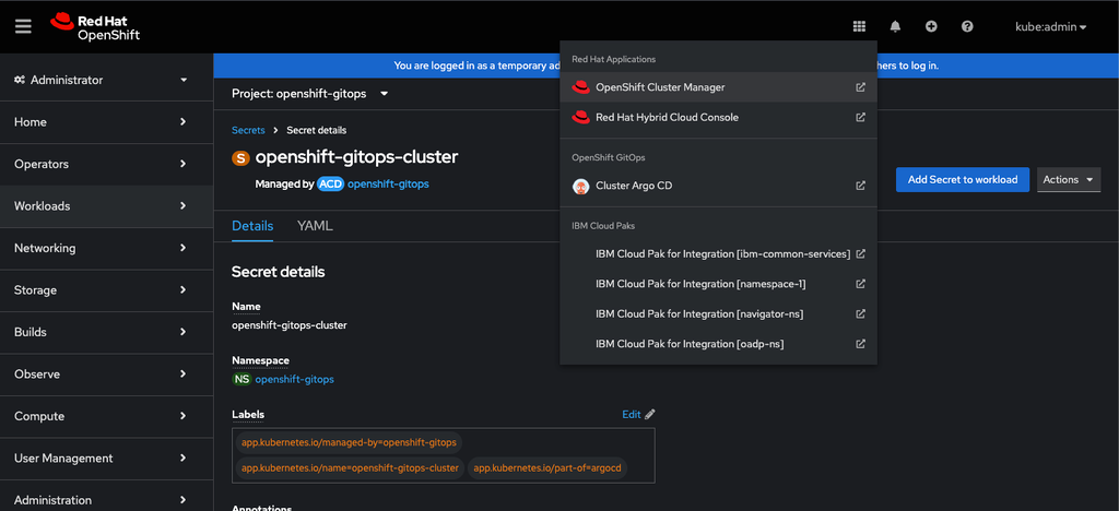

    Red Hat OpenShift GitOps automatically creates a ready-to-use Argo CD instance in the openshift-gitops namespace and an Argo CD icon is displayed in the console toolbar. You can see in the screenshot how you can access the Argo CD instance UI.
    Log in with the admin account (username: admin) and retrieve the password from the <argo_cd_instance_name>-cluster Secret under admin.password in openshift-gitops namespace.
    If you are a cluster-admin user, you have the option to log in via OpenShift SSO by selecting LOG IN VIA OPENSHIFT in the Argo CD UI.

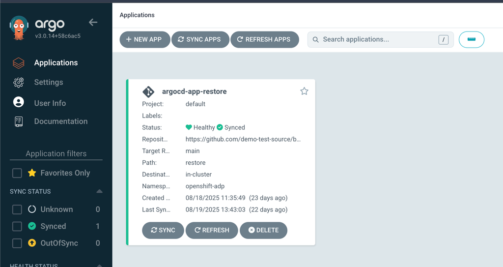

    To manage restores with Git, you need to create Argo CD applications that point to the Git repo paths for the `restore` resources (and optionally the `DPA` bootstrap). Argo CD will continuously apply and reconcile these manifests, and with `Auto-Sync` enabled, simply bumping the restore annotation in Git will trigger the restore again. The restore application should always be deployed, configured with server: https://kubernetes.default.svc, namespace: openshift-adp, path: restore, and syncPolicy.automated (with prune and selfHeal), plus syncOptions: ["CreateNamespace=true"]. If you also want Argo CD to manage your Data Protection Application, you can apply the optional DPA app. Once applied, these manifests create visible `Applications` in the Argo CD dashboard, where you can monitor their sync and health status.

    • After applying, open the `Argo CD dashboard` (from the OpenShift console menu → OpenShift GitOps → Cluster Argo CD). You’ll see the new Applications listed, where you can confirm they’re in `Synced` state and monitor their health.
